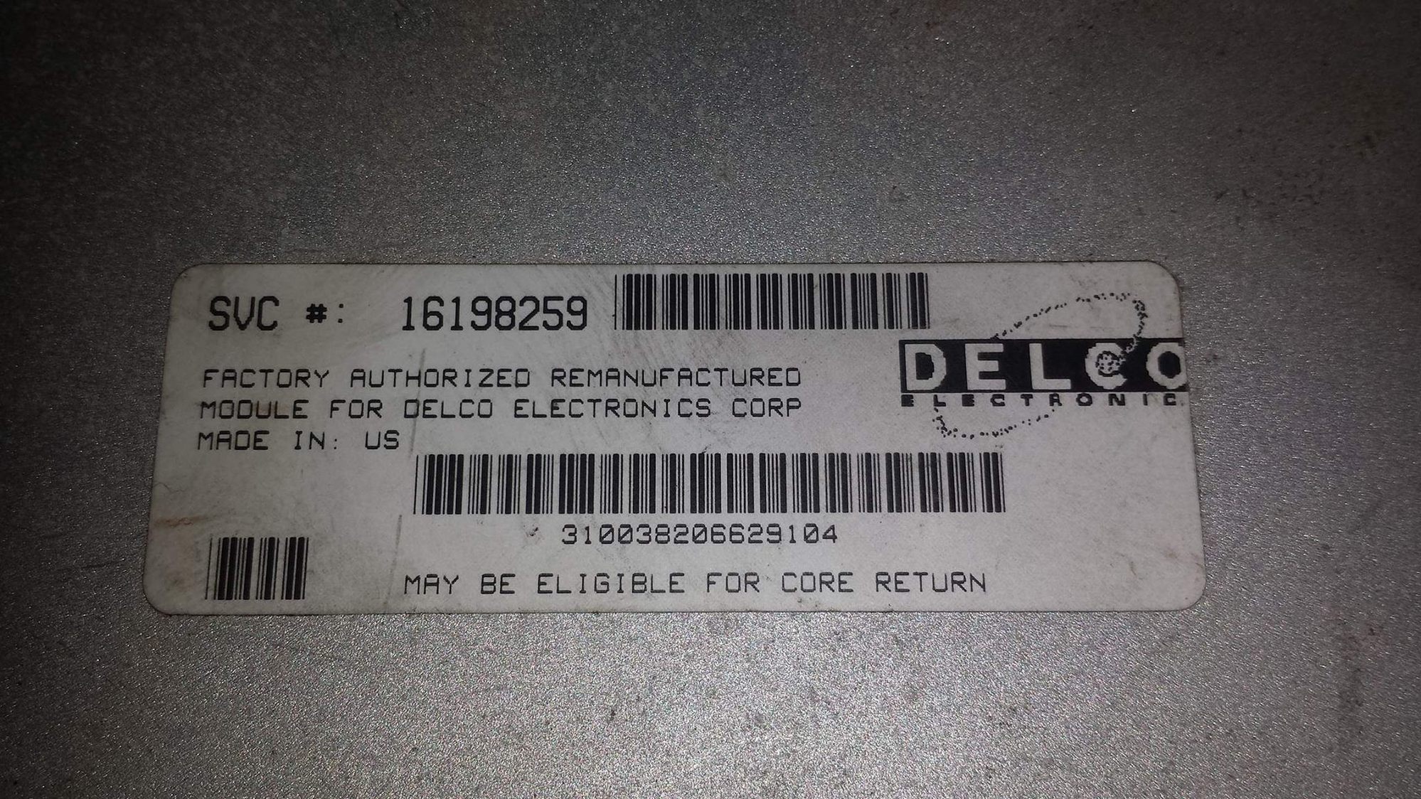

I was reading a SuperChevy article where they were able to replace the 82 ECM with a '90 Camaro ECM, so that it could be tune-able.
I also have a friend who has a '91 ECM, says it's out of a Camaro, and is willing to give it me free.
Attached pic is the S/N of the '91 ECM. Will this work or not as a substitute?

That's a TPI PCM. You need a TBI PCM. Basically, you have a split TBI on that engine -
each bore and injector is in a separate throttle body vs 2 in one throttle body.
The simplest one to work with comes from the 88-91 trucks. 1227747 is the service number. This one will pretty much wire right in.
A possible candidate for a more advanced one would be the 94-95 truck one with service number 16197427.
The one the article talked about was probably from a TBI F-body car, service number 1228746. Very similar to the 1227747 with the main difference being an IAT sensor.
HP Tuners will not handle anything pre-OBDII. But, there is a cheap (by donation) program called TunerPro that will allow you to tune it. Heck, you can even use an emulator and tune it real-time with the engine running.
