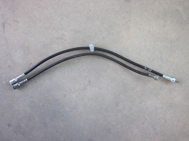

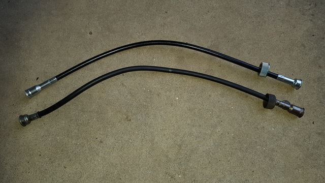

ended up shortening the outer myself at work and will use the original inner for now.
reason, had argument with place that was suppose to do the work, they had it for 3 days, not done, was only a fill in job for them, no hurry etc...
so i cut the steel liner on pin grinder and made a hex press block to re-crimp it on.
lucky i'm a toolmaker (fitter n turner) and have access to lots of good machinery.
