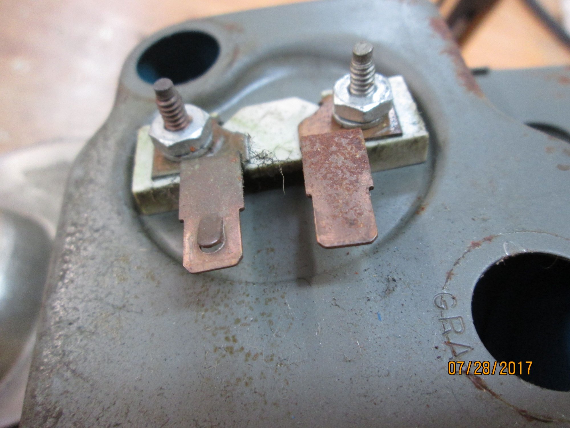

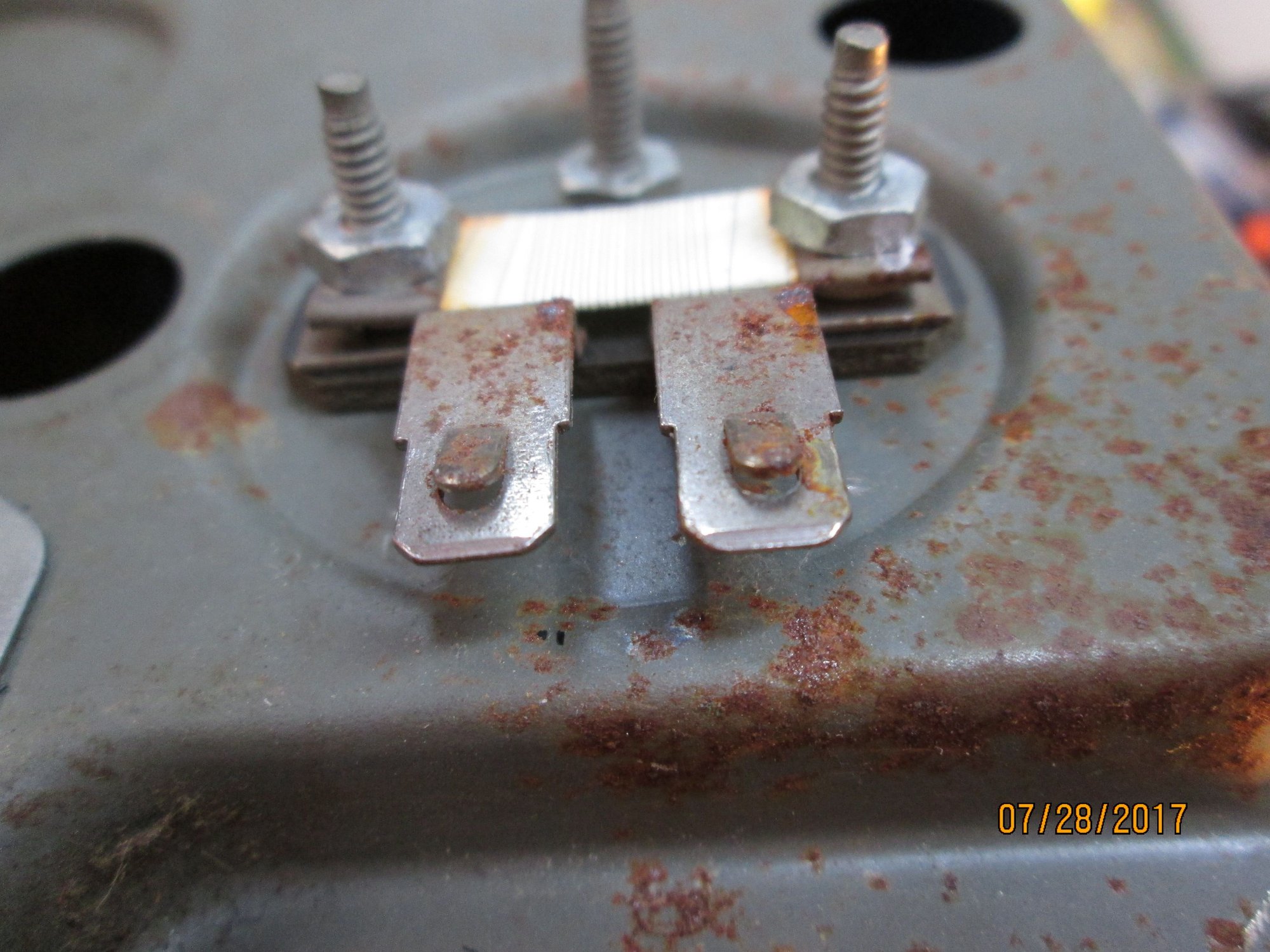

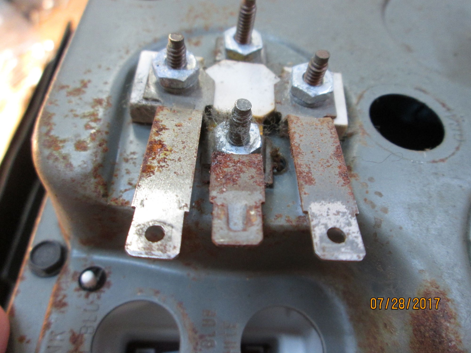

Yes the male connectors are keyed, so you can only install them on the gauges one way. The female ends have slots to accommodate the keys. This ensures that you can not plug a connector into the wrong gauge, or plug the connector on in reverse. The pictures below are from a 1973 center cluster, so there is no oil pressure connector, which is another connector yours will also have. (In 1973, oil pressure was connected by a capillary tube from the block to the gauge measuring "real" pressure, not electrical conversion via a sending unit as occurred starting in 1974.) Here are the following pictures to illustrate:
AMMETER
FUEL
TEMP
I hope this helps a little!

Dave, that helps a lot... looks like the "keying" is slight on the Fuel and Temp gauges.
But at least I know what to look for.
