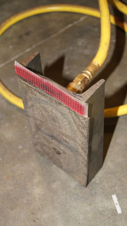

Using the "pedal method" to bleed the brakes will likely trip the valve in the proportioning valve. There is a plastic tool ($10) that temporarly replaces the brake failure switch / light and will keep the valve centered until bleeding is complete. Any loss of pressure in the system will trigger that prop valve. I will stick with the no pedal / Motive style or vaccum style. Thanks anyway.
What is the $10.00 plastic tool that holds the valve centered while bleeding? Can't seem to find it at Ecklers, Corvette Central or ZIP.
Rob
See below link. This thread is 5 years old, wonder what the final fix was.
https://www.summitracing.com/parts/s...+5d88fb1288741

^^^this^^^ Stop the presses! Its on sale too.
Yes, this goes way back.
Click on my avatar to the left, then my photo albums, brake bleeding.
There you will see what you need to buy or above ^^^^
Summit has it, but shpg $ ?
Try eBay maybe.

good call on ebay, they even have an aluminum version of this tool for like $5 shipped.. or a plastic one with 3 day shipping for $7 https://www.ebay.com/sch/i.html?_fro...Desc=0&_sop=15
