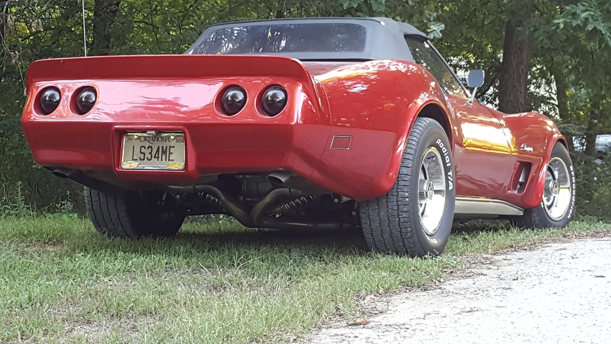

I have a 74 and didn't like the looks of the rear either. However, had I had a chrome bumper car,I wouldn't have went nuts on my build either. My 74 was probably the worst moment in Corvette history with Ralph Nader up the tailpipe with a paltry Ford Escort territory 190 hp L48, so what better starting point than over? I grabbed a high spoiler tail end
with morphed tail light pockets and un-morphed them.
Now that looks alot better,what would I look for to buy one of these rear panels? Thanks Phil

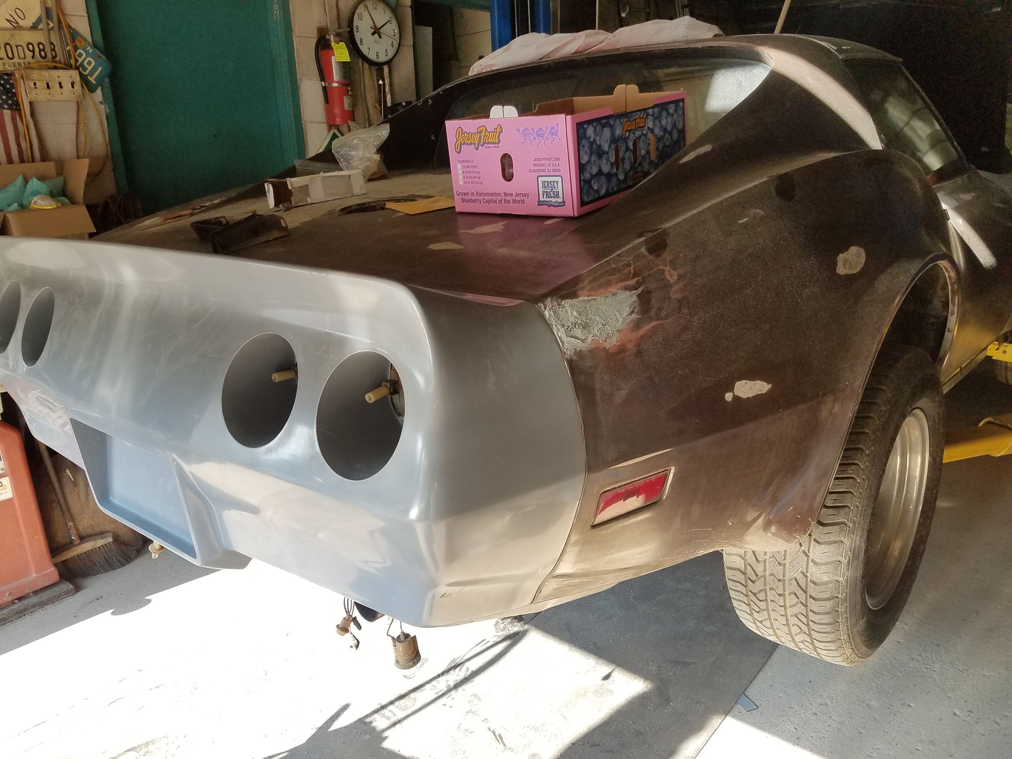

In a similar vein to Patro46's rear bumper cover some of the vendors carry a 1980-82 style rear bumper cover that bolts up in place of the '75 bumper cover. The spoiler isn't a stall as the one above, but it may be less work to fit.
BCF010 - '80-'82 Style Rear Bumper (Fits '74-'82)
You could contact ACI and talk to them about how much work is involved and see what they recommend, also which vendors carry this product.

When I bought my '74 coupe, it had an 80-82 bumper cover. But it was original urethane and was trashed. I'm (meaning the body guy; I'm not touching that myself. I dont have the time to figure out how to line it up correctly nor how to do fiberglass work.) Here it is in progress. If you loom at left side, you can see a ridge where it still has to be fitted correctly.
The short answer? You cant buy one. Sort of anyway.
The one I have originally had the high spoiler, just like you see it, however...
As far as the tail light buckets go, a LOT if work went into them. Originally, they had one horozontal cutout that held two tail light lenses instead of a seperate bucket for each lens. I took fiberglass and made individual buckets for each lens
