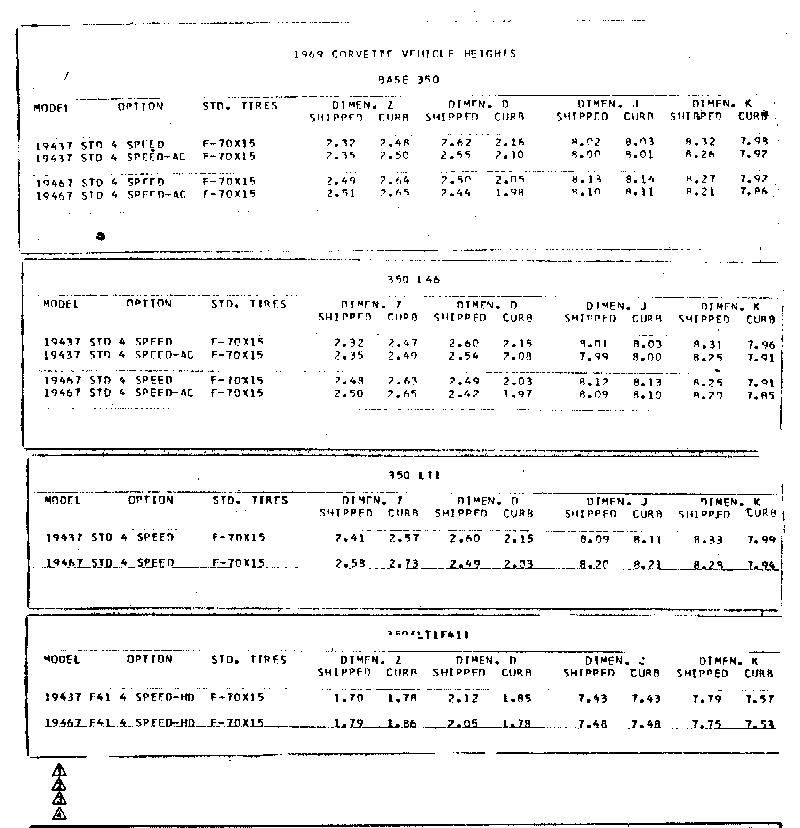

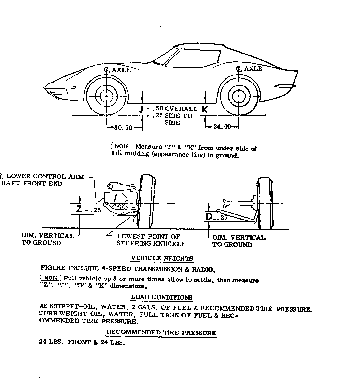

Ive posted this before but I didn't have too much info. My 1969 coupe sits too high in the rear. The spring is a 9 leaf that I thought was 2.5" wide. So long story short I ordered a replacement thinking that was the issue, pulled the original spring off the car and it turns out that the spring was in fact 2.25" inches. So I pulled a leaf out of the spring and put it back in. The drivers side sits at about 29.5 while the passenger sits at about 30.5. The car already has longer spring bolts which is the weird thing because I have more adjustment left in the drivers side while the passenger side is backed down as low as it can go. I have no idea why the car does this. Everything else looks right but I could be wrong. All I know about the car is that it had an older restoration back in the 90's. The tires on the rear are 255/60r15's and up front are 225/70r15's. Measuring from the garage floor to the wheel well lip. I quickly measured the frame right in front of the rear wheel wells so I may be off but it looks like the passenger side is 8.5 while the drivers side is 7.75. Any help I'd really appreciate it. I don't want to just throw parts at it because I already have to return this new spring to ecklers. I'm ready to sell the damn thing already cause I really thought the spring was wrong, so I'm really hoping for some good news or a point in the right direction. Thanks guys.

This thread has some things to look at.
https://www.corvetteforum.com/forums...-to-right.html

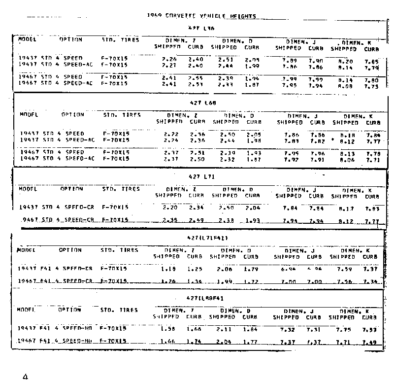

I would use the data above that applies to your Corvette and measure out the front and rear and see what is going on because as like it has been mentioned. You can have an issue in the front.
