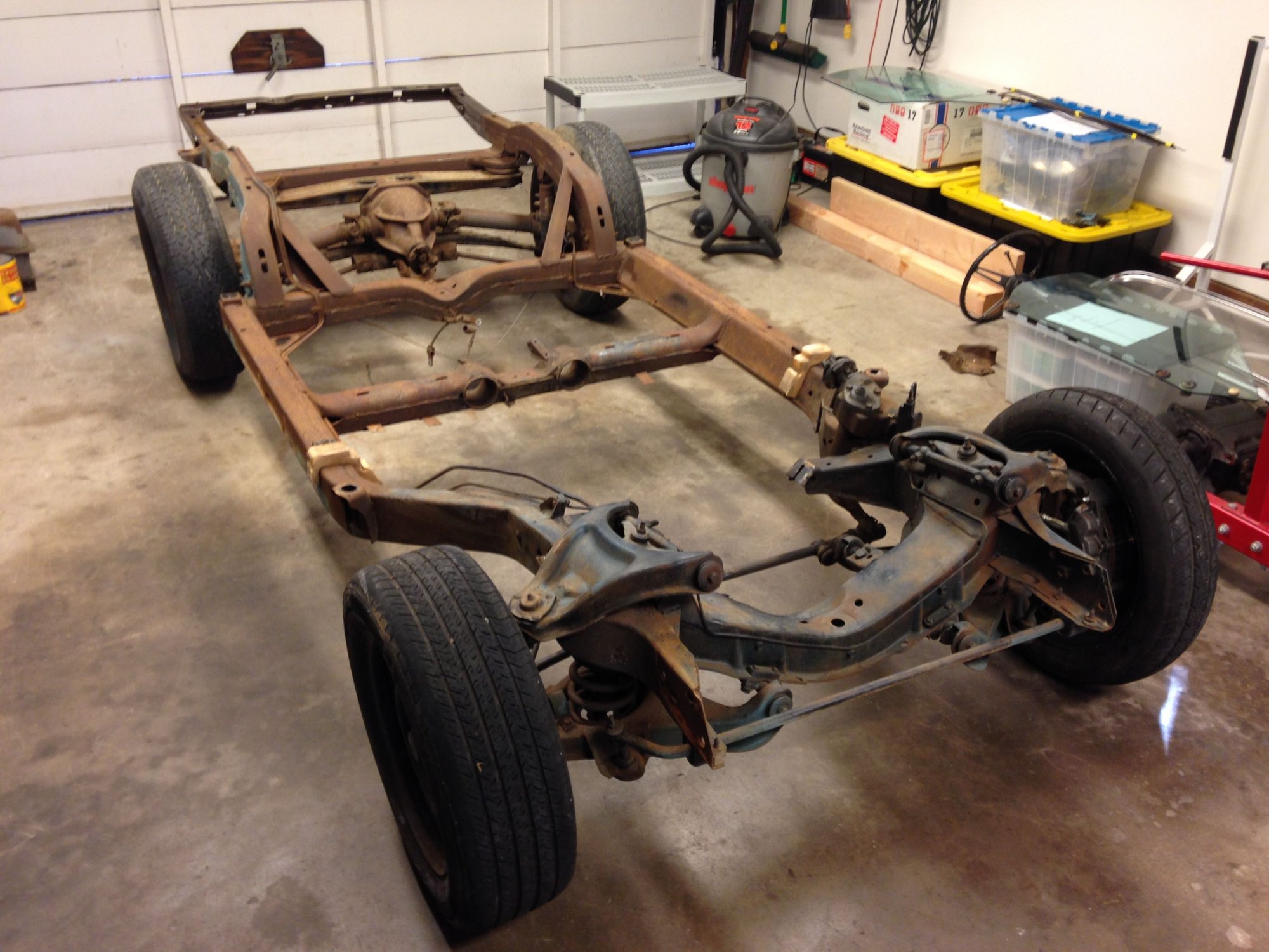

To clarify, I want to replicate this without the spring
Alan, I will try the piece of wood

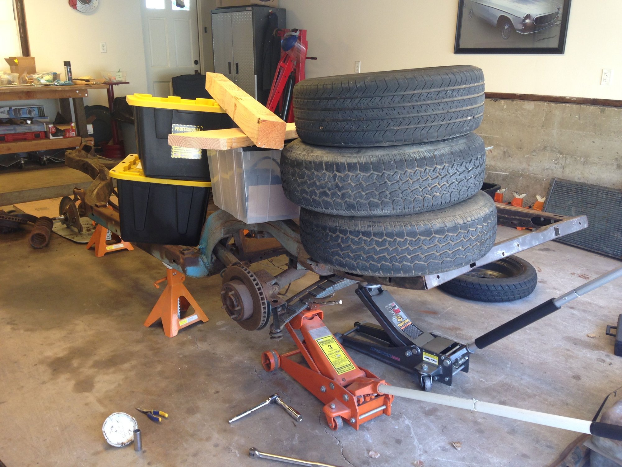

No kidding. To get the spring off I had to pile up all sorts of weight on the frame
Now that was pretty creative! Hey I guess it worked..........................

I got the idea for putting all the weight on the frame from a you tube video where they were getting some "big" boys to stand on the frame above the spring. The problem was I was home alone.
