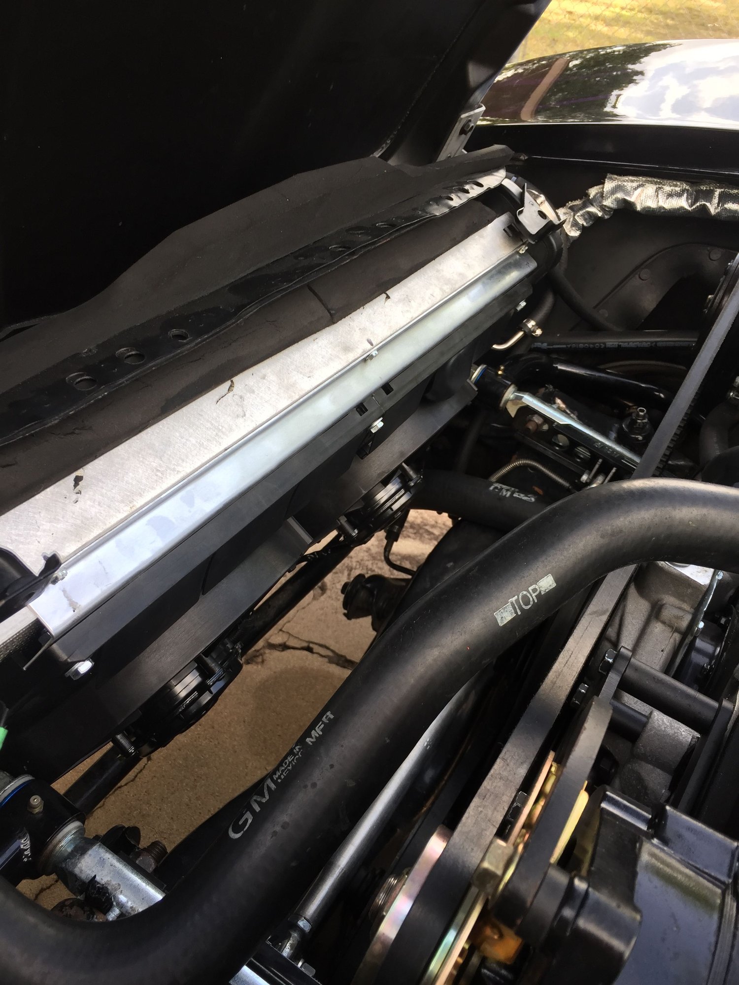

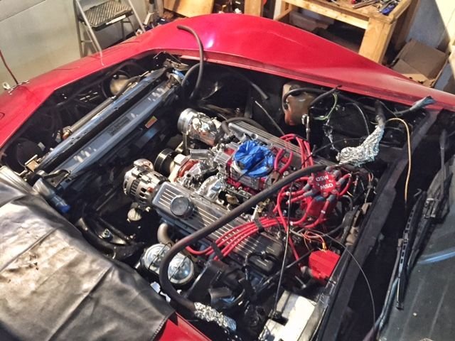

I went the focus fan route too. I used some small aluminum angle and a few cuts, bolted everything together. With the dewitts and focus fans I've never had any over heating issues. If anything it ran a little too cold and I had to switch out tstats.
Excuse my mess, I'm in the middle of an ls3 swap.
And here a pic from a few years ago mocked up with old radiator.
