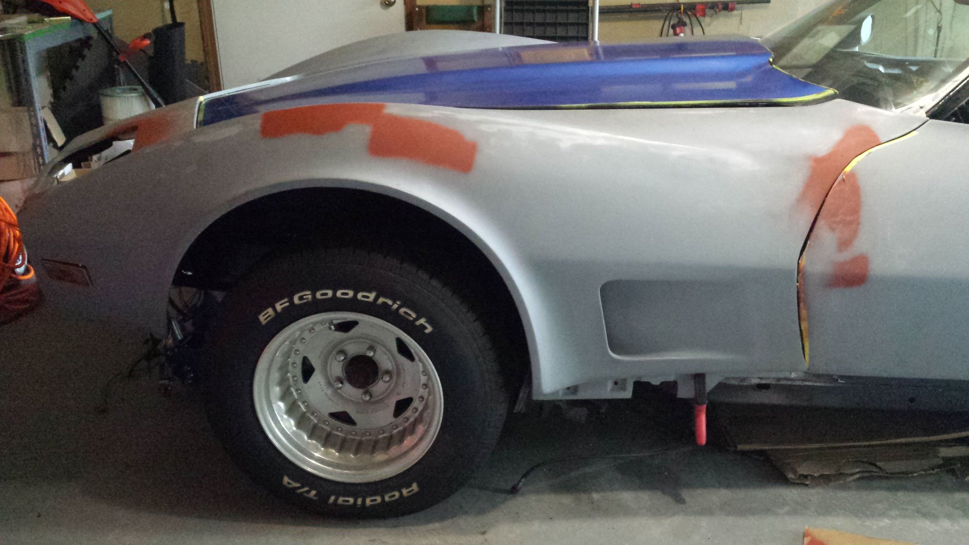

I am working on a 78 Silver Anniversary. I recently replaced the lower control arm bushings, lower ball joints, tie rod ends and sway bar linkage. I did my best to settle the front end. I then resumed installing my one-piece front clip. The clip is dry-fitted right now and it is getting close. (It has taken a LONG time to get to this point).
The problem I now have is the ride height in front, which appears to be the same on both sides (5 1/2 above the tire o.c.). I believe that this is about 3" too high.
The frame is 9 1/2" from the floor just behind the clamp in the photos, and 8 1/2" from the floor below the back edge of the door.
I have not tightened the front suspension yet because I wanted to make sure that the front end is in fact settled. I have looked at all of my available references (repair manual, and AIM) and done internet searching including a search of this forum.
I read that the rear spring may have collapsed when I had the front end of the car high up on jackstands with the rear tires on the floor. The spring is a fiberglass replacement so I don't think that is likely.
I believe that the front coil springs, which are original, were reinstalled correctly with the tighter coils at the top and positioned correctly in the control arms.
It is a little tough to settle the front end without the front clip attached.
So my questions are:
Should I jack the front end up and let it drop on the front wheels a couple of times to settle the suspension?
Will tightening the front suspension parts drop the ride height significantly?
Would it be a bad idea to finish the front clip install before resolving this issue?
Do the frame to floor measurements indicate that this is a suspension issue?
Thanks

Looks very high to me too, are you sure those are the right springs?
Each spring a has a socket or notch in the lower control arm, double check that each is fitting into the slot.

Did you tighten the bolts that hold the ends of the control arm bushings in. I never tighten them until vehicle is sitting at ride height.

I just checked. I did not put the passenger side in yet. Drivers side were in but not tight. I loosened them more. Thanks

Could the stabilizer bar be installed "backwards"?

Well, the stabilizer bar was upside-down. Correcting that only brought the ride height down about 1/2". Tomorrow I will raise the car up and tighten everything up. Then we'll go back to the front clip fitting.

Do you have the correct Chevrolet Service Manual? The dimensions for correct ride height are clearly shown. You measure the distance from the floor to the bottom of the ball joint, and from the floor to the inner pivot of the lower control arm. That is the only way to correctly determine your car's ride height. Fooling around with the tire to fender gap is a waste of time. So is setting your clip to the tire. Yeah, that should look right, but the foundation (the frame) has to be right first.
You have to seat the springs fully into the pockets in the frame. It's kind of tricky, but if they are just a little out of the pocket, the car will look like yours does in the photo.
Get it right, or you'll be chasing this forever.

Thanks Pete, I do have the service manual. I will check those measurements. I agree that the springs are the likely culprit. They look right but its tough to see especially in the upper control arm.
