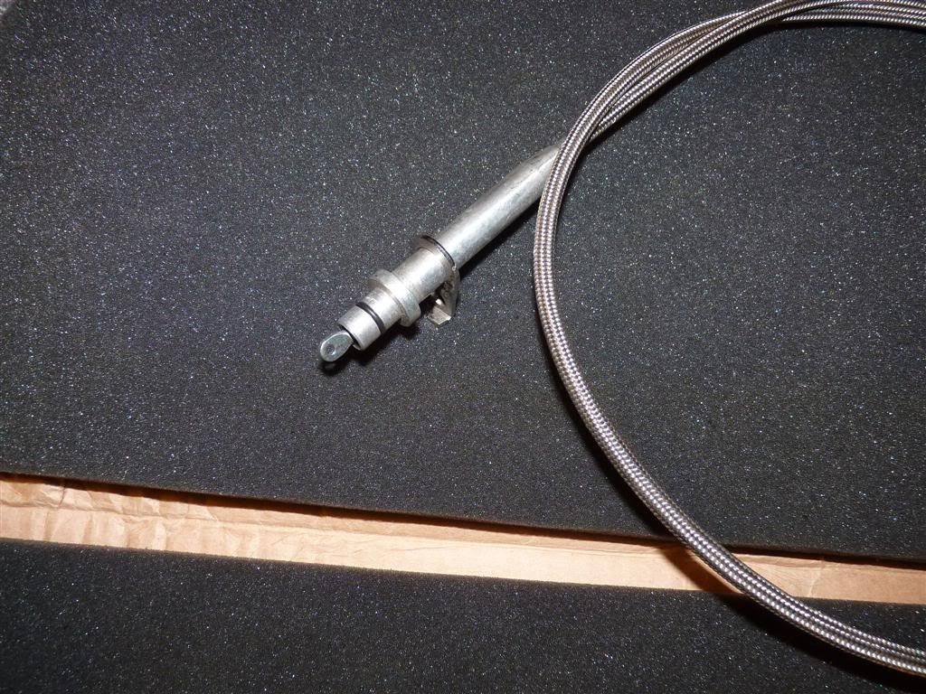

I have this lightly used Lokar cable that costs $76 at Jegs...Will sell for $20 plus shipping to lower 48. You can also buy a stock style for around $20 at your local parts house I believe.

Originally Posted by 80L48
Well, it sounds like I am on the right track. Only the accelerator cable and vacuum lines currently attached. I'll have to go look at transmission and see what is at the other end of the "missing" cable. Any idea where I would find it attach to the transmission? I have the service manual, but I am out of town
It's attached via a 1/4" Hex Head bolt next to the dip stick tube. Possible a 10mm bolt since you're an 80. Fluid will flow freely if you remove it :-)
Black cable @ 5 o'clock this image
I think I will proceed, don't like having to shift manually, (would have gotten a 4 speed if I wanted that)
What linkage is that a picture of? I called Willcox and they do not carry any cables, any suggestions? I just want a stock one to connect to a Edelbrock 1406 (I know I may need a bracket 8301 or 8306)
You need the little metal rod you see existing the bracket/lever on the valve body...likely you don't have that piece since the hole is epoxied and that little rod would be residing in the hole the cable goes into.
Can't provide non-supporting vendor links but type in "Automatic Transmission Detent Cable" in search block after entering your vehicle in the AdvanceAutoParts website....or part number Y-100. Part number 8036 is for the bracket at the same joint.
Willcox has this one for a 81 fwiw https://willcoxcorvette.com/catalogsearch/result/?wcc_part_year=&q=Automatic+Transmission +Detent+Cable
