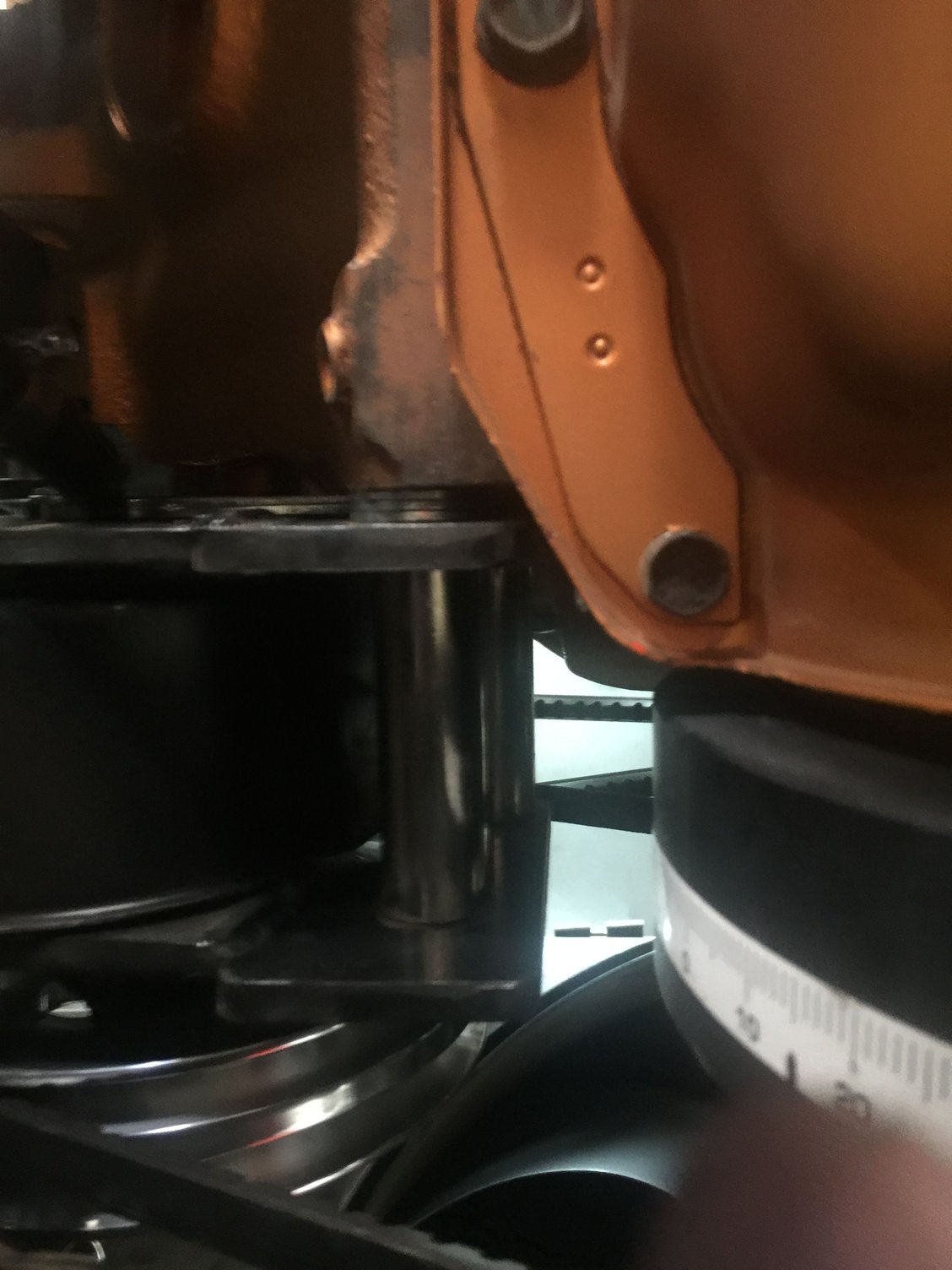

Originally Posted by ronarndt
I'm planning my winter project for my 68 BB convert. I would like to add the Steeroids R&P power steering conversion to my manual steering car with NOM 454. I expect the hardware installation of the rack, tie rods, etc will be straight forward, but I would like feedback on the power steering pump, pulley and bracket installation. I had to fabricate a bracket for my alternator when I changed to aluminum heads, so I may have fitment problems with the PS pump brackets. Anyone done this conversion with advice?
Ron,
I swapped out the SBC for my BBC this past winter and installed Steeroids R&P while I was at it. All I had was SBC brackets etc so I had to go online and search for what I needed. I ended up fabbing my PS pump bracket because the fancy BBC I ordered one sat too low on the block and the pulley would hit the cross member. I'll take some pics tomorrow night if you would like? Easy Fab job mate.
Cheers,
Ryan

Originally Posted by Ryan Menzies
Ron,
Cheers,
Ryan
Thanks. Photos would help me plan what I need to do. I have fabricated a bunch of stuff for this car already. Latest was a strut brace similar to the shark type, but half the cost plus my labor. I already have a custom bracket for my alternator, so one for the PS pump would complete the set.

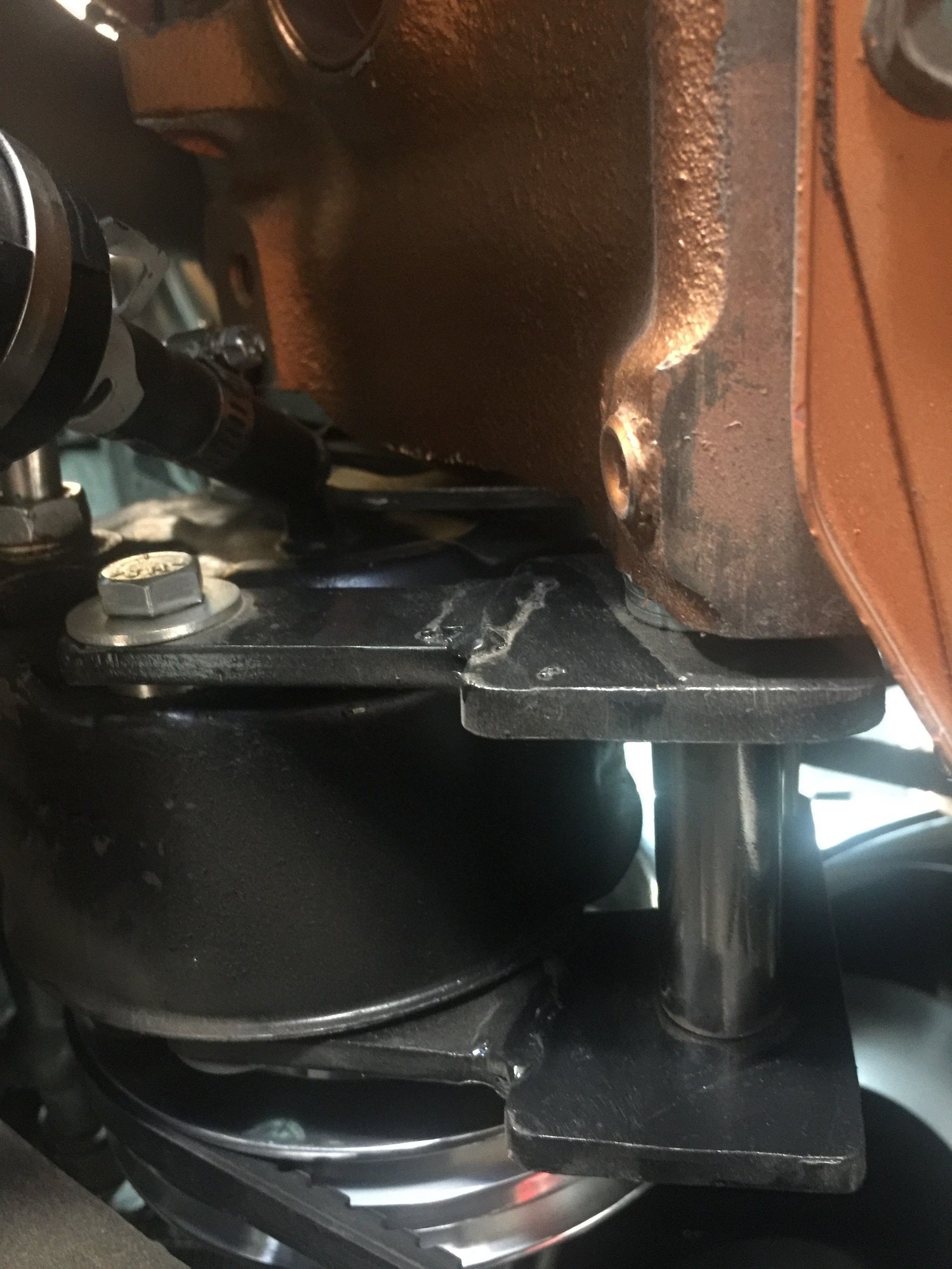

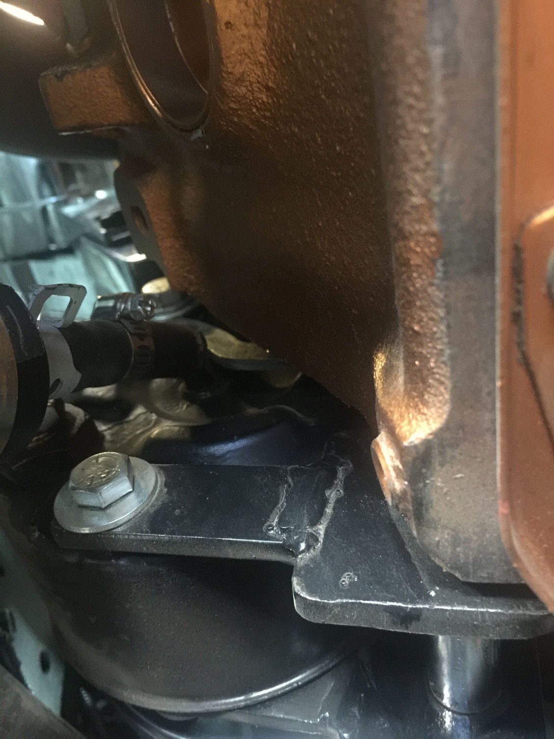

Ron - here's the original start of this. Right PS bracket idea, wrong PS bracket application.
Just to get your thoughts jumping a bit regarding the PS.
Chat tomorrow.
Ron,
I used the two bolt holes in the front of the block that the bracket would usually bolt to. I used some 3/16 flat bar, cut 1 piece to fit against the block after drilling two holes and welded another piece to that. The 2nd piece was just for length to see how far down I could put the pump before the pulley hit the frame and to see how far back, away from the engine (towards the left fender I wanted to go). I ended up using the existing 3/8 bolt holes on the bottom of the pump (facing each other-one on each side mirroring the other)
To keep it off of the frame I ended up going perfectly lateral away from the bottom bolt that was in the block. Essentially a 90 degree right angle.
Now the top, adjusting one (I can't get a pic) is supposed to go from the back of the pump to the third bolt hole in the block (You can see it a bit in the chrome bracket pic). Because I raised my pump up, the filler cap was very very close to the big *** alternator bracket and I didn't have a lot of adjustment) so I went and used the top bolt hole that also was used on the bottom part of the bracket. Made an adjustable slot in the fab piece and good to go. I used a couple of washers between the block and bracket to line it up perfect.
Sorry my friend, I'm not a machinist or a welder but this would give you a head start-or at least show you what i did.
Cheers
