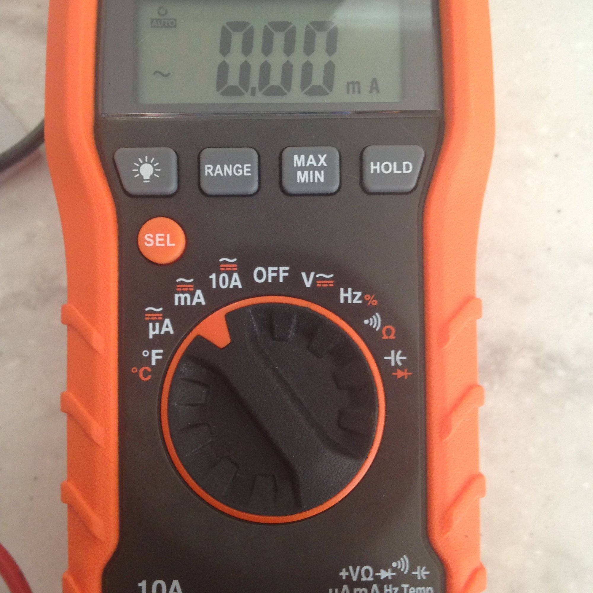

Here's a pic of my multimeter, and how it is set to get the .84mA reading. I used the 10A lead plug-in for the "0" amps reading, then switched to mA. Also made sure I was set for DC current. This may well be 840mA, if so please school me. [img]webkit-fake-url://e87acbd8-f621-4e9b-bb14-9920b4a99cb8/imagejpeg[/img]

Ok, apparently I don't know how to post pics. My meter dial is set to mA, the red lead is plugged into the 500mA max plug, not the 10A max plug. DC current is selected with the button that toggles between AC and DC. The reading on the screen is 0.84. When I checked using the 10A settings, I got "0".
So you're probably at .84 milliamps then which isn't much of anything.
Figured it out!!!!!!! The posting pictures part anyway.......... The leads didn't show up in the pic, but for mA I'm plugged in on the right hand side, for 10A I plug in on the left hand side. The black lead plugs in the middle.
