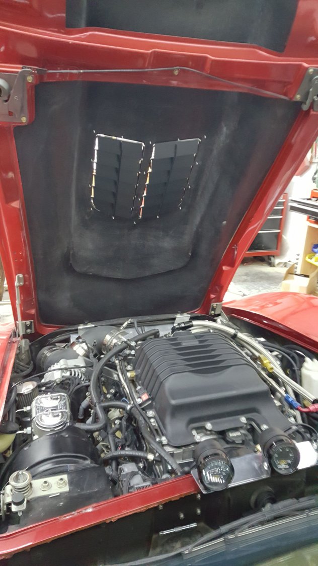

I went with an Fbody, but you can use others. HP Tuners and few credits opens up of WORLD of tuning options...
For ease of install, make sure you get a running engine to start with. I didn't and there is an easier way. That means engine, PCM, wiring harness and decide whether you want an auto or standard transmission (wiring harness pinout change)
The rest is pretty straightforward, and the end results are shall we say.....
worth it?
750 HP, LS3/LSA ,Air Cond, Power Rack and Pinion, overdrive, 3:73 coggs. Boils the BFG 295-50-15's at 90 plus mph. 17.4 mpg @ 65 mph.
