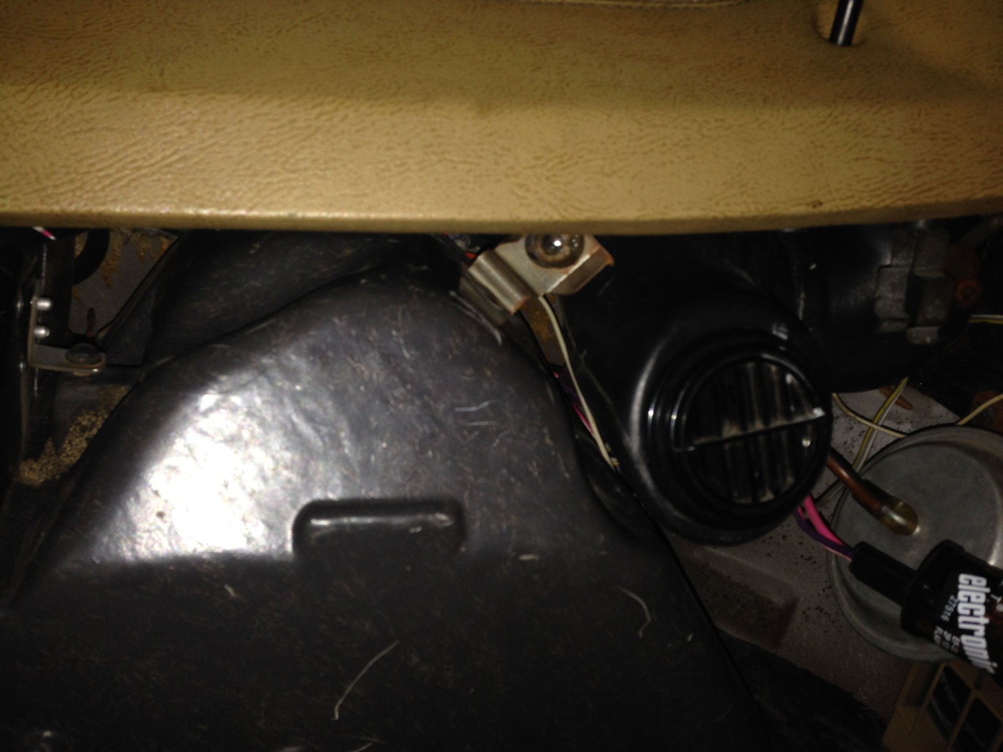

Thanks Alan. I don't remember my 75 looking like that underneath. I'll post a picture tonight. I have factory AC on the car, if that makes a difference.
On mine, there appears to be an elbow duct connected to the vent with the footwell light squished up between it and the dash pad.

Yes, I have an assembly manual. I'll dig into that. I'm actually trying to change the footwell light, which the base is loose and the bulb is jammed in tight. Here's what mine looks like underneath.

Did you remove the kick panel?
Odd.. you should only have the three screws at the top, the door jamb and the dash bezel center screws holding the pad in place... Then remove the kick panel, and the radio side panel... Usually once you have all of those out the pad will just pull right now. I'm with the above post, something else may be holding it either in the vent ball housing or some other alteration.
Willcox
