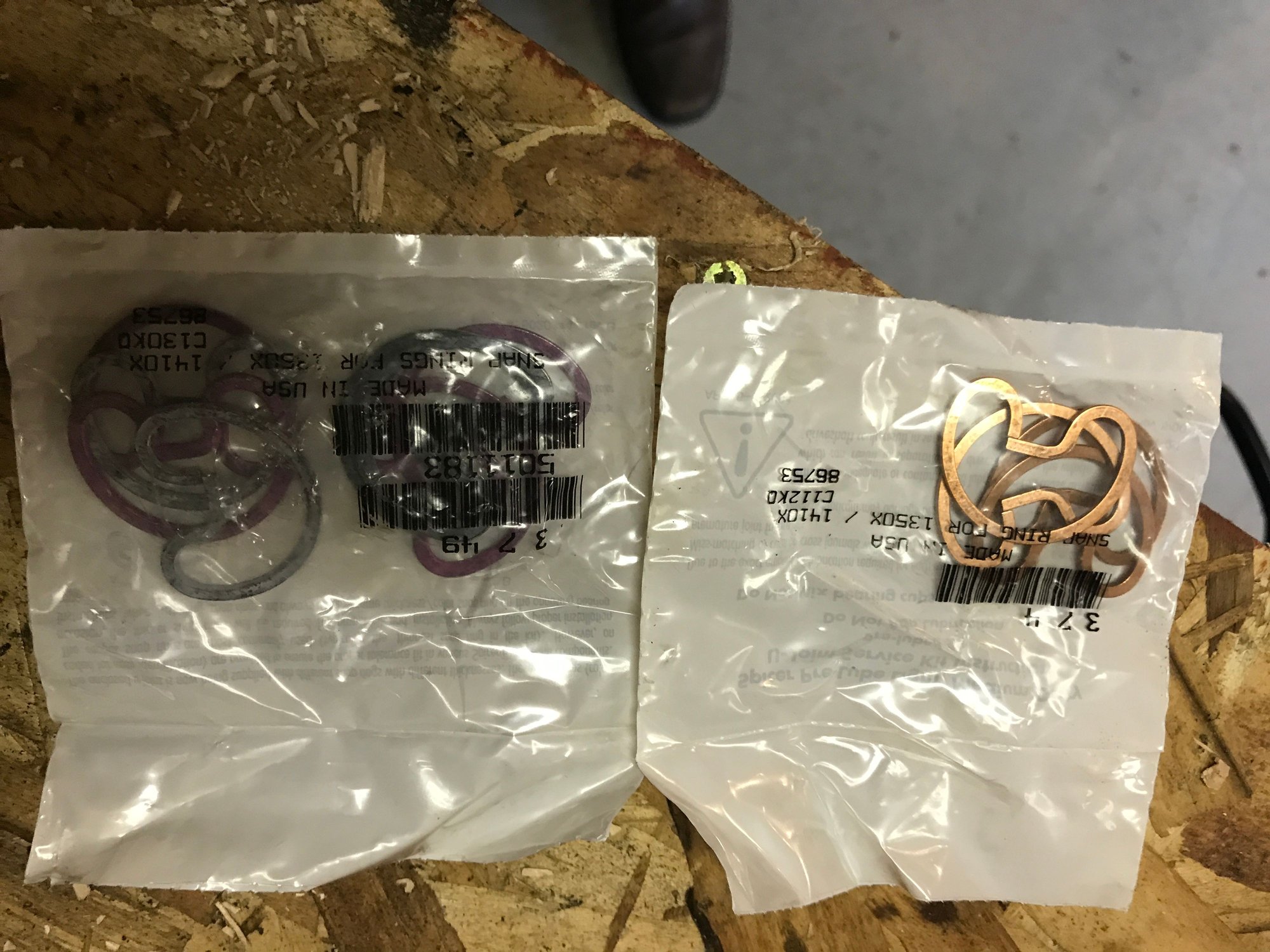

Here is what I bought
There are three sets of snap rings. Copper, silver and purple. Maybe different sizes? No idea. Thoughts?
Baggie says Light/Medium Duty Service Kit. "Pre-lubed Do Not add lubrication"

Yes they are
Yes the retaining rings are different sized for the groove in the yoke, that can fool you tho if your caps are not pressed in all the way, also there is so many of them for the full round yokes where all 4 caps are pressed in and no straps

Use the copper colored. Be sure your snap ring grooves are very clean.
Mike
Thanks Mike.
Are the others a different size? I'll just toss them in my parts bin I guess.
Unless somebody can use them.

Yes, the color indicates thickness and copper is the thinnest but still a bit tight. I wish I had a use for all the extra ones, got a few hundred of them.

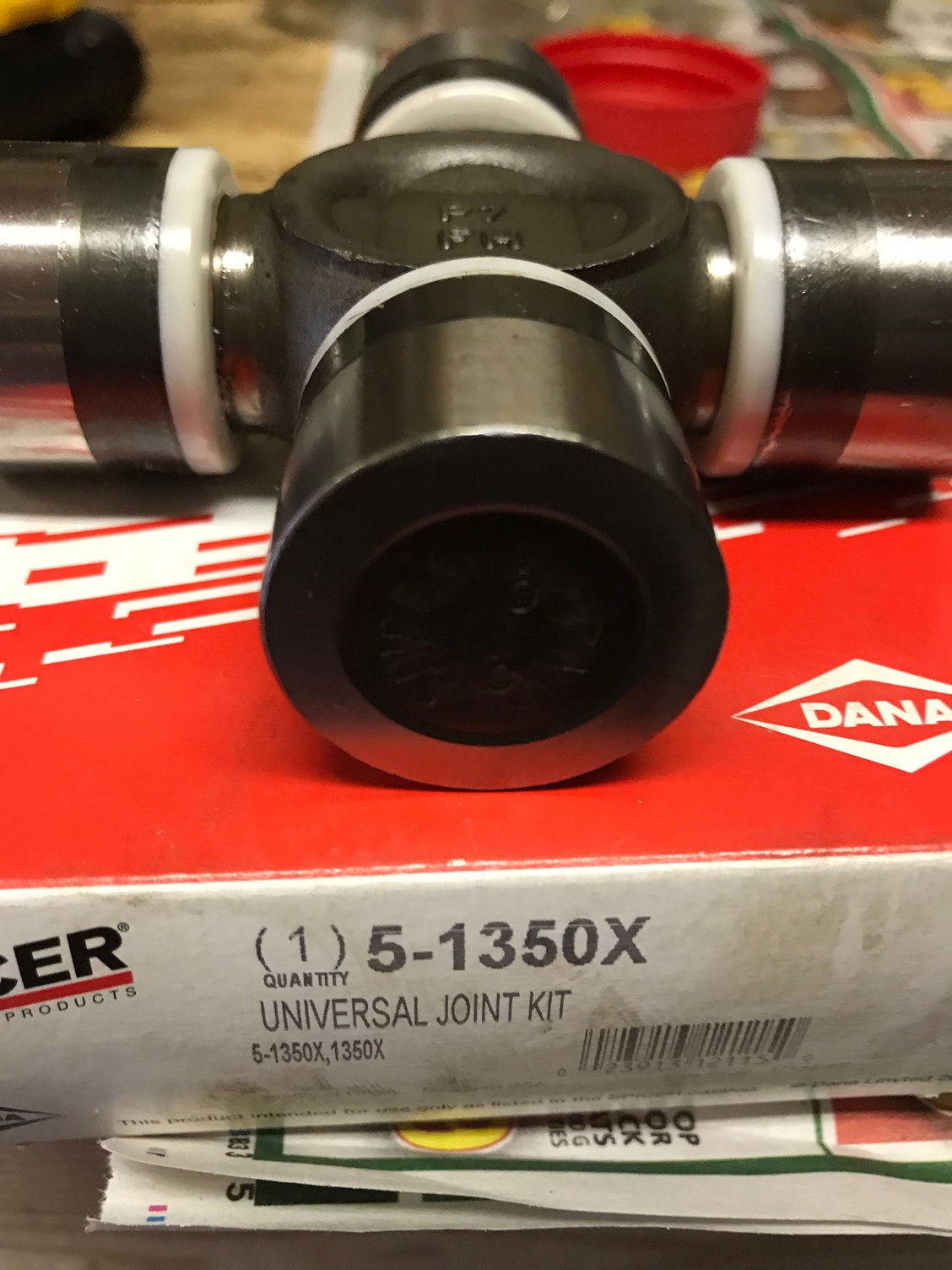

Originally Posted by Dodosmike
Dub, thanks. I was curious about inside the cups.
The 1350's came in the mail today. I unfortunately don't have a press, so I'll use my trusty dead blow hammer and my c clamp.
I'll try to get a couple pics when I start the assembly.
I know you are going to do what you have to do if you are determined to install these yourself and not take them to a driveline shop that can do them for you.....so.... be careful if you are hammering on it.
Also if you have an Oreilly's around you or other auto store that may offer the service.....I know Oreilly's offers tools that you can rent. Give them a deposit..and when you are done....take the tool back and you get ALL your money back..so it does not cost you anything.
DUB

I've got some 2x6's rigged up as a cradle. Got the two joints and the flange installed tonight, but I can only get one copper coloured clip in each joint. Don't want to pound on it to "make it fit".
Oh, yeah, the parts place shorted me one set of copper clips. Nice.

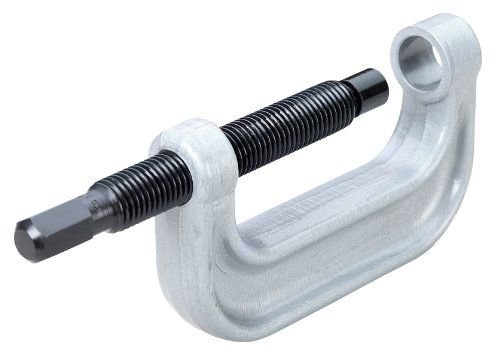

The U-joint press I am referring to is a large 'C' clamp that is tighten by using an impact....and not so much a stand up type hydraulic press. Mine looks just like the one in the photo below
But as how it was stated...AFTER you have it installed.
DUB
You can buy DUB's at Autozone or any of the major auto parts stores.
http://www.autozone.com/test-scan-an...ool/499640_0_0
or get this one as a loan-a-tool
http://www.autozone.com/loan-a-tools/ball-joint-press
or buy another version at Harbor Freight
https://www.harborfreight.com/ball-j...les-63279.html
Some of these are combo tools allowing you to do u-joints AND press-in ball joints also. Removal and install.
Depends on if you plan on doing more than one.
"Never can have too many tools"
"Buy the best quality you can afford unless you will only use it a couple of times (Harbor Freight)"
Bman (Dennis)

As stated by 'bmans vette'...the tool I posted a photo of is a 'combo' tool from OTC and it can do more than just U-joints...it also does the pressed in ball joints...so ....seeing how I have it...I use it.
