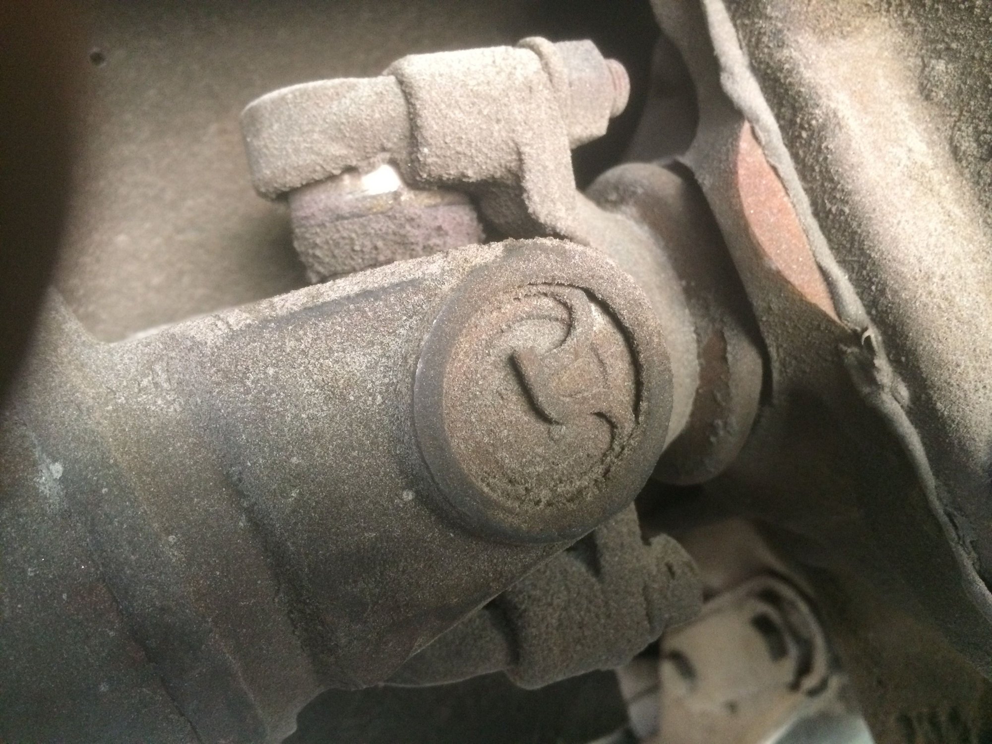

I have what sounded like a bad ujoint yesterday. Cant reproduce it but still hear it at times. On inspection I noticed a clean area on half shaft ujoint. I'm thinking its getting ready to go. See pict and tell me what you think. Replace, Reinstall or Ride? Thanks

I vote replace. That can't be an indication of good things to come.

Another question. Is this enough to cause a noise/problem as it is now? Worried that yes it needs replacing but no its not causing any problems yet. BTW: No yoke play and wheel bearings are good.

That HAS to have a messed up cap.
That would probably mean messed up needle bearings.
Last time I had this happen on a Yukon it sounded almost like a rock stuck in a rotor. Just a constant grinding noise.
When I got it all out that cap just fell off and what was left of the needle bearings was comical.
But I'm open to being wrong, surprised someone else hasn't chimed in. Asking for opinions is the key in forums. Surprised someone hasn't suggested a crate motor to fix it yet

The bearing cup shouldn't have rotated like that. I would at least check the u-bolt nuts for tightness and while you're at it see of it has any play BUT you need to take the half shaft out to be able to check it with any degree of certainty. And if you have to replace it replace all six of them at the same time.

I think the bearing cap has seized on the bearings and the joint and the seized cap is rotating with the joint inside the u bolt. I would not drive it very far like that.

Correct me if I'm wrong. (Never done this)
Each shaft end is connected with 4 U bolts. So its just a matter of loosening 8 nuts per shaft, removing the shaft. Replacing the U-joints and reinstalling shaft. I will be replacing all U-joints on both shafts.
Anything I'm missing or tips?

Any shiny spot amongst dusty areas like an oily spots amongst dry areas makes me investigate further. The problem becomes the tendency to "well, while I'm at it I might as well..." I would replace all u-joints at once however. A Harbor Freight coupon and a hydraulic press make the job easier.
Incorrect.
The pic shows 2 u-bolts which means 4 nuts.
But to replace the u-joint, the other two caps are pressed into the yoke end of the half shaft or the drive shaft. Those require the clips taken out from the ends and the u-joint either driven or pressed out. Then some serious cleaning and making sure the new caps fit in precisely. Then reassemble. Stay away from u-joints with zerk fittings. Go with Spicer solids.
Good luck to OP...and do it soon.....
