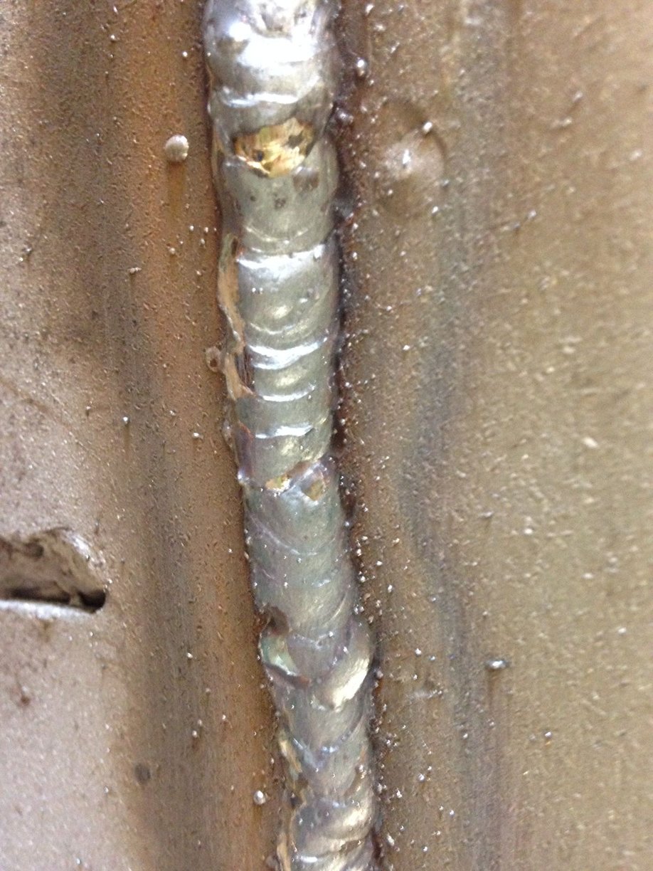

Comparison of factory weld and my weld. Mine's not as pretty as a professional welder could do, but it is burned in good and is not going anywhere.
Mike

I am actually afraid to comment...to try to give some advice on what I see....still knowing that you are not worried about it being a show car....which has nothing to do with what I see.
If you are good with it..then all is good I guess.
And I am guessing you are straight line welding...which I would describe like taking a pencil and pulling or pushing it across paper and making a single line....and it does not need to be 100% straight line but more rather a single line.
DUB

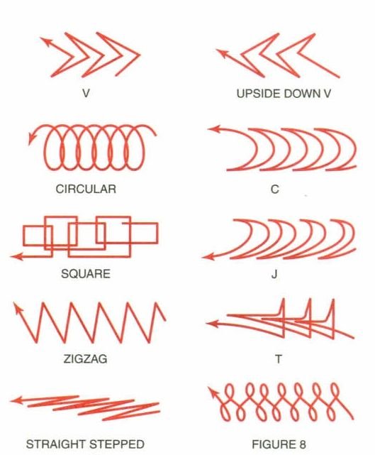

If I my suggest...instead of going back and forth...do circles...or curly q's...that way you get more width where needed and and allow the weld to lay down a bit better.
Look a the 'circular pattern in the photo below and that is what I and trying to describe. and PLEASE understand I am on your side and just trying to offer some advice that may help you
And if you need me to..I can post a photo of how this looks because I just welded on a strut rod bracket today.
DUB
DUB
Thanks Dub!
I've found that the circular pattern works best on the really dirty areas. It will spit some of the fill out and then I loop around and pass over it again.
The zig zag pattern works well on clean metal.
I'm getting better as I go. I have maybe an hour or two left is all though.
I welded most of the bottom today. It was way dirtier than the top. Good thing I started on the top and figured out how to deal with it.

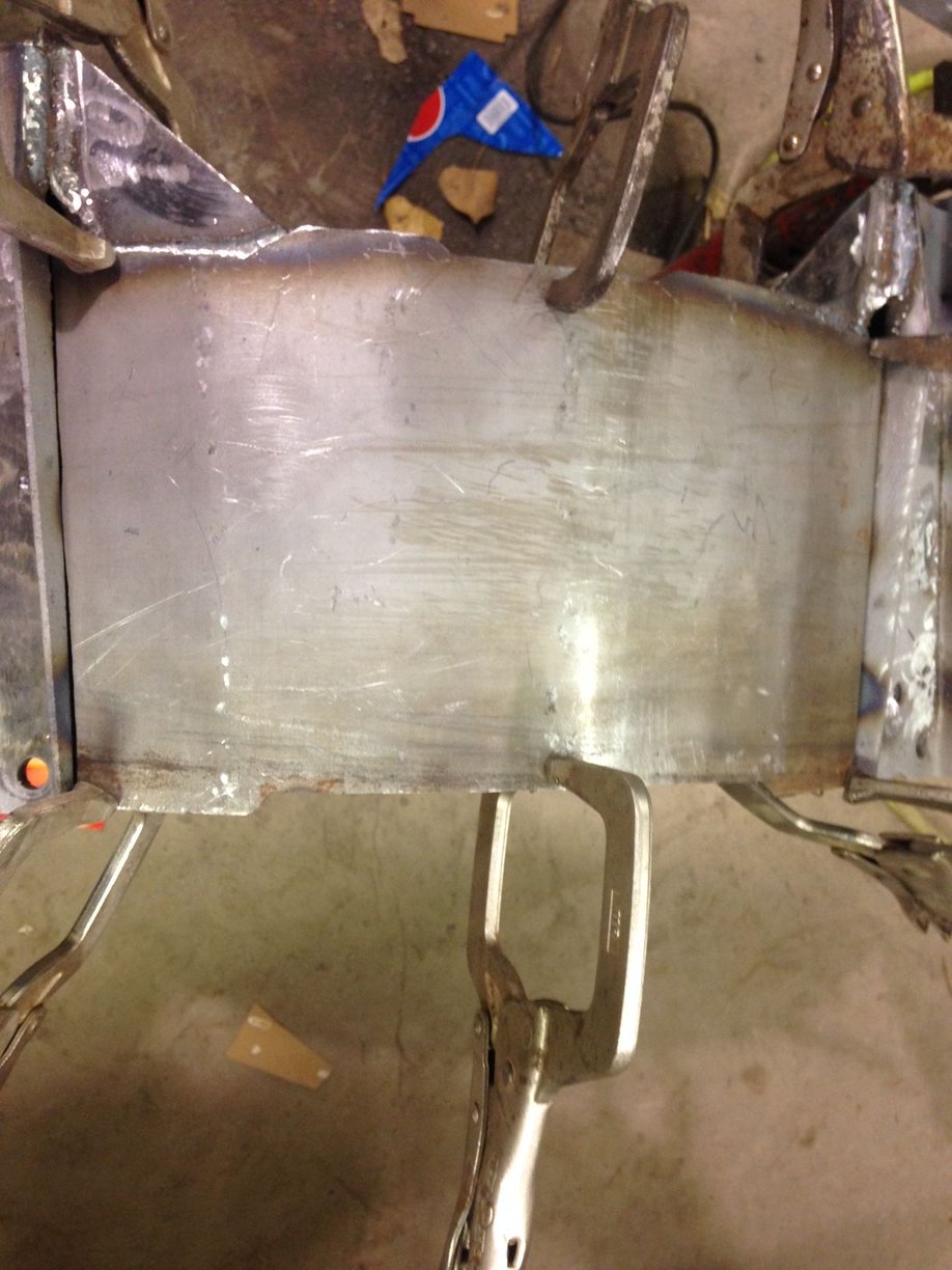

Made a new bottom piece for my front cradle/crossmember out of high grade .125" plate steel. It is way stronger than the original bottom of the cradle.
I shaped it with a press and then clamped it in place, tack welded it and then used a BFH to get it to lay properly. I welded it solid to the lower a-arm mounting brackets and to the cradle. With the other gussets to the mounts and being rewelded, they are not going anyplace now!
Photo is before I tacked it in place. I forgot to take a photo when done before I came home. You get the idea though.
Mike
