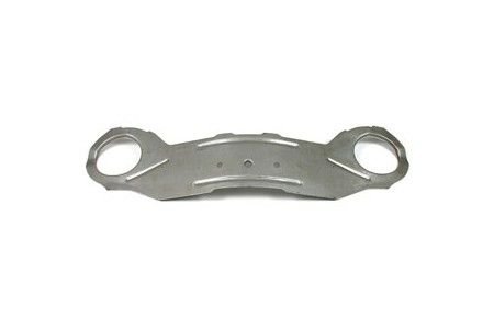

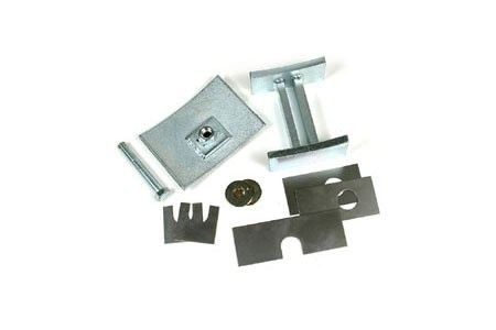

If you were referring to the cross member, Zip Corvette sells the repair piece and a kit to repair the cross members:
Repair part:
Kit to repair lower cross member dents:
Repair part:
The piece I made is to reinforce the cradle and to weld to the bottom a-arm pivot mounts. If you've ever seen photos of torn off lower a-arm mounts, you'd have see the bottom of the cradle rips like paper. The piece I put on is thicker and a stronger grade of steel. It also shouldn't dent by lifting the car there with a floor jack.
I'm not sure if OldCarBum was looking for a repair piece or a stronger reinforcement like mine.
For a restoration project, the pieces you showed would be nice, but cutting the old cradle bottom off would be a big job. A lot of welds and spot welds to grind off.
Mike
