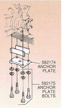

There are spring plates/spacers available that were used with 2.25" steel springs in certain years when the narrower spring was installed in the 2.5" differential. Would likely work with the narrower fiberglass spring.
Those vertical spacers would work for steel, not a FG spring.
I think the "plate" that mounts between the spring and the diff cover is what dictates what spring goes in what year of car. 77 and earlier the "plate" would be 2.25" and 78+ is 2.5"
Im wondering if I just get a '78 "plate" the spring that was previously mounted on a 71 (for example) would fit, because its the plate that is the correct width, not the spring itself.

Anybody have a photo of the plate that the spring sits on?
If all VB&P springs are 2.25" (according to their email), only the plate, for lack of the correct name for the part, NOT 582714 in revitup's pic above) then I just need the correct width plate to mount to the 2.5" wide diff.
