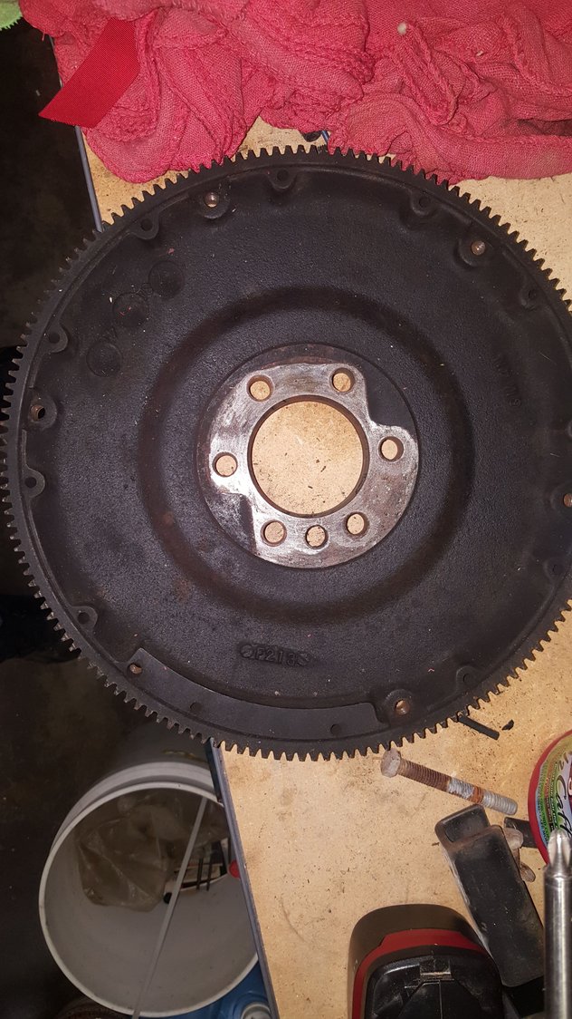

I finally got around to buying and installing a proper 427 flywheel. The Bendix now engages properly and all is well. The 454 flywheel ring gear was (thankfully!) shifted nearly 1/4" in the rearward direction when mounted on the 427 and the Bendix couldn't quite reach it, so the starter motor just spun with no engagement. This is a bit puzzling to me, and suggests the 427 crank is somehow different on the flywheel-mounting end. Whatever, all is good now! Now here's what's really puzzling. Here's a photo of the 454 flywheel. No counterweight! The casting number is 3973456N, and research generally indicates that it's a 70's 454 flywheel, but I did find in a forum where folks said this was the incorrect flywheel for a 454. The block casting number is 3999289, so it's definitely a 454 block. Maybe someone swapped in a 427 crank, making the flywheel correct for it. Who knows?

Here is the GM 10.5 clutch lightweight flywheel used on the LS-7 BBC.

I put a 400 small block in a boat. Went to core guy to get 400 flywheel. He sold me a 454 flywheel. Bow rails on that boat shook like the front end of a Triumph motorcycle. Whole boat vibrated unbelievably.
