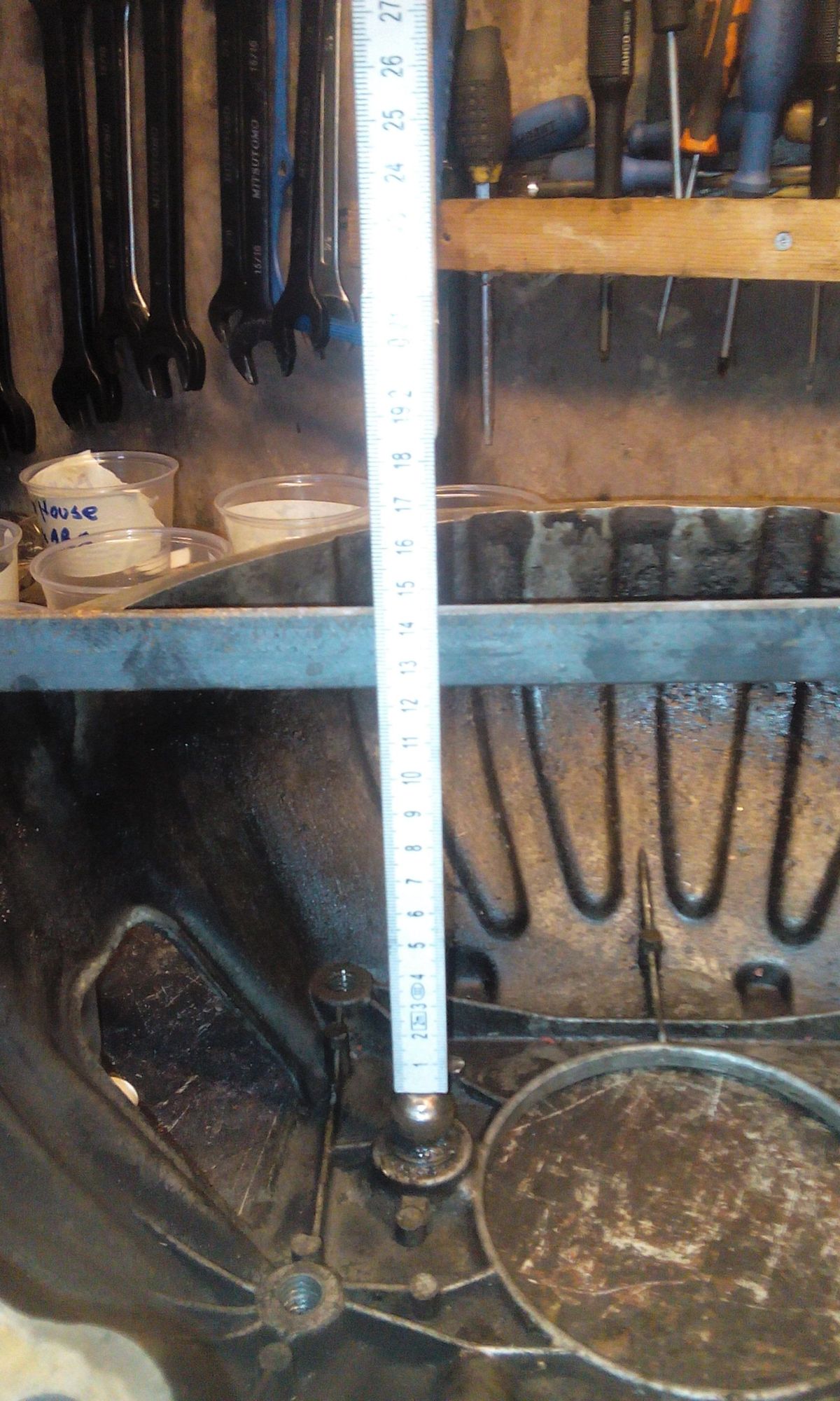

Good point. There seems to be some confusion as to how they are measured. Centerforce suggests that this is the proper method.
The factory bolt is 1.25" "inside" like you show here.
I will measure tomorrow, as in your picture, with the old bolt, the new is on it's way.

Originally Posted by buns
^ Exactly.
.960
-.722
=.238
4.75
-.238
=4.512
So, by my calculations (someone could double check), you need to set the ball height at 4.512"
I cleaned up the diagram, leaving out the block saver plate.
My measurement says 4.881, it must be 4.512
Difference = 0.369"
My old pivot ball is total 1.369" (1.25")
The pivot ball I've bought is total 1.78"
Difference = 0.411"
0.411 - 0.369 = 0.042" (1mm)

Some info I found on the interweb.
The 3729000 ball stud ( at 1.5" overall length ) was used on all Corvettes from '55 to '81.
Except at the beginning of the '66 production they switched to the 3887159 ball stud, ( at 1.375" overall length ). It turned out this shorter ball stud could cause the clutch fork to hit the bellhousing. Later in '66 they changed back to the longer stud.
So, somehow, it appears that the shorter stud ended up in your bellhousing.
It looks like the longer stud you have on order will match up fine with your thinner flywheel.

Originally Posted by gkull
GM 3790556 Clutch Fork Ball Stud (1 3/4 Long) Or 1.750 - 1.369 =.381 =9.6774 mm
You only needed 7-8mm, but a couple of mm is not a big deal. It is just the pivot point for your clutch fork rod. I installed a 21 pound SFI steel 168 tooth flywheel in front of my tko 600 and with the short ball stud sent by keisler the clutch would not disengage. So I went down to the local chevy dealer and bought the longer one
And it helped, now I have a clutch again
