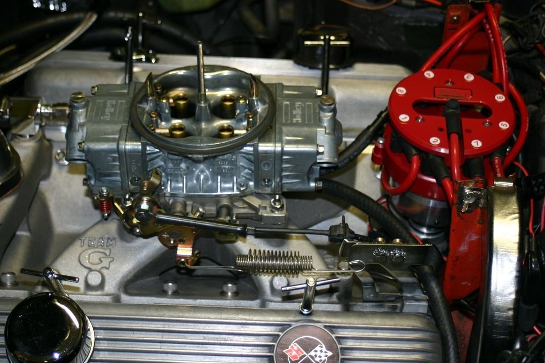

Will a Holley affect the value of the car? Heck yes! It will make it worth more!
Holley - Holley- Holley and never look back. Easy to work on, easy to find parts and they look awsome sitting on a Edelbrock. Just my humble opinion.

I originally put a 4175 vac secondary on my '69 several years ago. Bolted on with no mods other than I had to raise the aircleaner base 1/4" with a spacer to get it to clear the secondary diaphragm.
After my recent engine refresh I changed to a 4165 double pumper and had to get an aftermarket drop base because the secondary lever hit the stock breather tube and I didn't want to cut the original.
I love the Holley spreadbore series. Very easy to tune. The issue is that most people do not tune them and just bolt them on. That is a recipe for a bad experience. Holley assumes you are not bolting on to a stock engine and you have made some performance improvements such as a cam and headers, as well as they are tuned a 70 degrees at sea level. That means it will run rich for most people.
The 4165 (at least mine did) comes with a 62 primary jet, an 83 secondary jet, 25 primary squirter, a 37 secondary squirter, and a 6.5 power valve. When I bolted it on the engine ran fine overall but was very rich at idle, very rich at cruise, lean at WOT and there was a slight hesitation at transition from primary to secondary.
I have a stock L48 cam and stock manifolds. After some quality time with an O2 sensor (also love the bolt-on O2 bung from FiTech!) I changed to an 8.5 power valve, 59 primary jet, 89 secondary jet, and a 40 secondary squirter. Also adjusted the idle circuit screws and now all is great with the world.
Friends don't let friends bolt on a Holley with tuning out of the box.

Originally Posted by DUB
BUT...keep in mind that Holley is not a simple install.
Taking into account the air cleaner base more than like will NOT fit correctly...the factory bracket for the accelerator cable and transmission kick down cable will not work and need to be modified or something else 'figured out. The vacuum fitting in the top of the intake
in the #8 intake runner might now be effected. The choke may now need to be looked at.
The fuel line going into the front of the Holley...(depending on which one is purchased) will need to be looked at.
The vacuum going to the power brake booster is something else that will come up...which...once again...depends on which Holley is purchased.
And finally...checking to see what the vacuum is on the engine is so the power valve in the Holley is the correct one needed....because you never know.
Lastly...is the actual clearance under the hood (between the hood and air cleaner) when you shut the hood. If the engine has the dual snorkel factory air cleaner...and you loose that and have to put on an open element type...and then have to run a shorter air filter....to me...it makes no sense going through all that...instead of keeping the QuadraJet and having it set-up correctly. BUT...that is my opinion.
DUB
The end result was worth it to me but there was a bit of figuring things out as you noted and what worked best but it wasn't that hard to do (on a Team G). That's a 4"X14" air cleaner on top of a Team G intake. There is still a full 3" gap between the lid top and bottom on the inside. It fits under the stock '76 hood.

Originally Posted by jb78L-82
Dub,
Just an FYI that the Holley 4175 is a direct bolt n replacement for the Qjet:
https://www.summitracing.com/parts/h...waAs0wEALw_wcB
I have this one on my 78 C3 and have since 1985...it is a direct bolt on. I would get the OEM Qjet rebuild/tuned by LARS if it was me to keep it original, if I was doing it today...Love the holley though....
I put one of these on a guys Corvette a few years ago...but he changed the air cleaner and the hood was not stock.
Are you still able to us the factory air cleaner...under an original hood???
DUB
