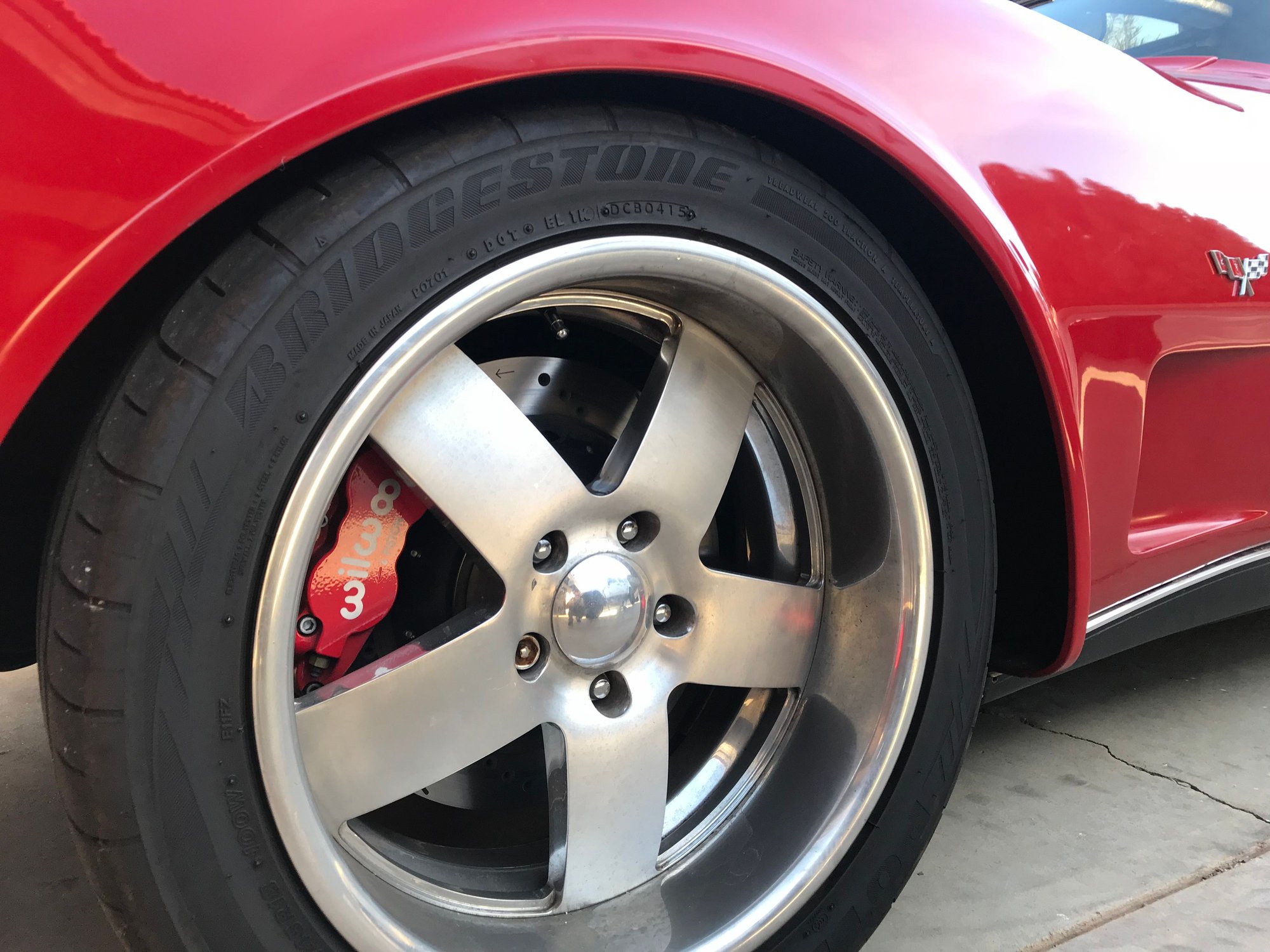

Originally Posted by SHIFT A
There is no need to input mathematical equations that fly straight over most peoples heads; it is common sense to anyone who knows a bit about cars and rotating mass, such as weighted flywheels, etc. that when you move weight out from the center of a rotating object, it becomes harder to initially rotate and then stop from rotating.
That may be true for some cast wheels, but you are not considering that all wheels are not constructed the same. For example my 17x8 aluminum wheels use a cast center disk welded to a thin spun rim (see below picture). The center of the wheel is quite thick for strength, but the outer rim is almost the same thickness as a steel rim. Even though the volume and radius of the outer rim increased some, the large density decrease going from steel to aluminum resulted in a net decrease in both mass and rotational moment of inertia. The moment of inertia of the center cast section did increase, but the outer portion of the rim decreased drastically resulting in a ~20% reduction in the overall inertia value compared to a 15x8 steel wheel.
do you have a picture straight from the side?
Here's mine when I had 235/50ZR17's Michelin PS2's on it, which had a 26.6" diameter. I run a considerable amount of "rake" in the suspension to optimize the handling characteristics of both the front and rear suspensions. That's why the front is so much lower than the rear.
Here is an earlier picture when I had 255/50R17 Nitto 450's (27.0" dia) on it and the rear end was set a little lower, before I figured out that raising the rear end resulted in less bumpsteer. I preferred the way the car looked with it sitting lower, but I gave up some aesthetics for better handling.

Correct
Mine are a 2 piece rim, a spun Aluminium barrel and a billet aluminum CNC cut center section, then welded in to correct back spacing for 275’s or larger

So four wheels consume about 11 hp or less than 10% of the power required to accelerate the car itself. Given the small differences between the various combinations of tire and wheel sizes, I would say that matters very little. The steel rally are about 13hp. Obviously handling is a different situation with a lot more going on, but I was curious how much the wheel’s masses mattered. Not all that much.
Well that’s enough fooling around - I’m waiting from parts from Summit!
________________
* Note - just to check order of magnitude, I did find an online calculator that said I needed 240 hp at the flywheel and that was based on Edmunds sample data which would include lots of other real world things like air resistance, gearing, etc. Makes the wheels, which are a much simpler entity, even less of a concern
Finally.
Sorry man, that's not me - Don't take this wrong, you might try "The Pleasure of Finding Things Out" by Richard Feynman - a fun read
You are so smart! Problem is my reading level is only at AR 2.7 and even my kid’s Dr. Suess books are hard for me to comprehend, so I’m pretty sure I won’t be able to read that book.
No seriously, please forgive me for my smart a$$ sarcasm (I just couldn’t resist), and thank-you for doing your math work to help prove my point, even though I’m sure most people like me didn’t really understand it so it’s hard to trust it (no offense, you probably really are a super smart person).
Anyway, I never said that adding the extra weight and the fact the weight moves to outside of the assembly (when comparing same wheel makes) when going up in wheel size makes a huge difference, but it does make a difference that at least I am trying to be mindful of. I have built my Vette with weight reduction as a key goal to help improve performance.
In my real life experience (not mathematical theory), I noticed a significant decrease in acceleration just from going up from my 17 Inch to 18 inch combo; it was the same wheel style (AR TT2) but the tire and wheel combo added 5.7 lbs per wheel and the tire was about an inch taller because I didn’t want the thin rubber band look and wanted more ground clearance. I know tire height plays a big part in acceleration too, but the added weight/rotation resistance also made a difference.
Of course what good is having a lighter weight wheel/tire combo on acceleration if it doesn’t hold traction? This is a main reason I want to go back to 15s with street drag radials on light weight TT2 (other than wanting the classic look back); because they will hold traction better than any UHP street tire reguardless of the size, I just hope they don’t give up too much in terms of handling. I don’t plan on autocrossing but I do like pushing through curvy roads. I know the 15 inch Drag radials will improve my straight line acceleration, but if they take the fun out of driving through curves, I will most likely switch back to UHP street tires.
Going off topic a bit; but if you have the time, could you please do some equations to help prove how a car’s weight effects cornering performance? (Seriously, not being sarcastic this time). I know that a lighter car will cause less sidewall flex. I also know that a heavier car will force the tire to the ground and increase traction that way, but I’m also pretty sure that a heavier car will lose traction quicker when pushed.
