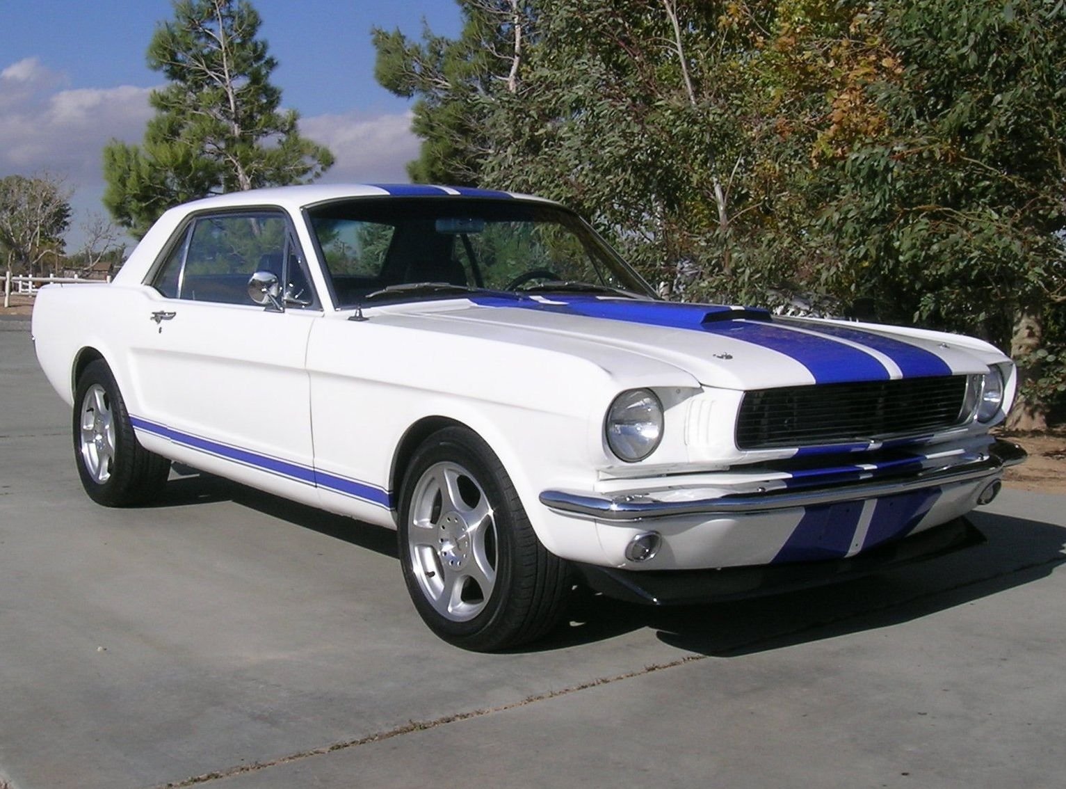

Originally Posted by jb78L-82
I don't LOVE them but I had to make a sacrifice of looks versus performance............
Yeah, that reminds me of when I put 2005 16 inch Mustang wheels on a 1966 Mustang I restomoded. I didn't love the looks and got a lot of mixed opinions, but they were definitely lighter and performed better than the stock 14 inch steelies.
So Sorry, I promise to never post a picture of Mustang again!! Don't beat me up guys, LOL

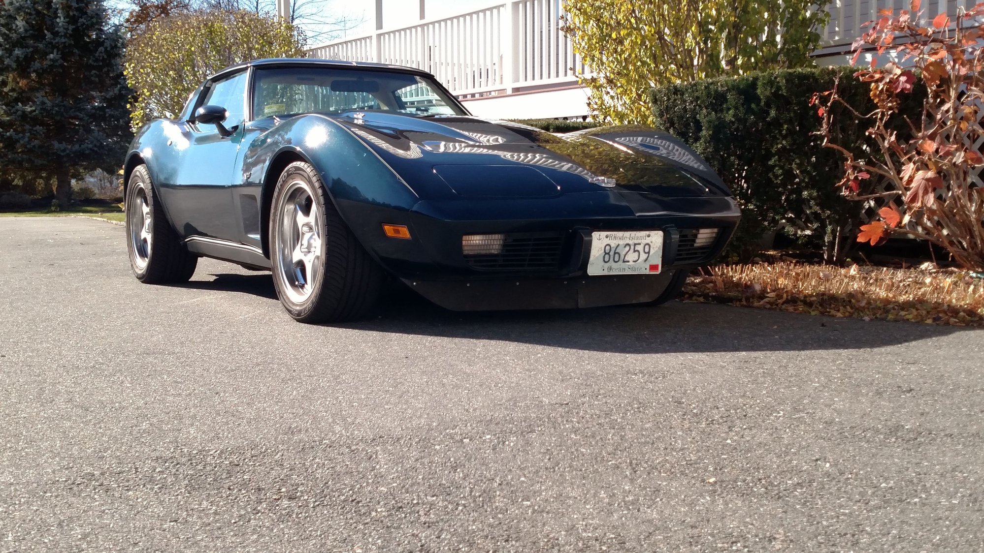

JB, please don't take offense. People's opinions on looks is same a taste of food....there is no right or wrong. Its purely a personal thing. I had no intention on bashing your choice, as I know you have stated in other threads that you have chosen performance over appearance.
The picture does reveal the other aspect of larger wheels that I would have to find a way over is how much they often do NOT fill the wheel well enough. It is very obvious, and some are worse than others. Quite often they look like mini-wheels not properly matched with the openings. That is why I have said I would have to make sure the tire I used would be at least 27 inch in diameter, and slight more would even help. The tire outside diameter should be concentric with the wheel opening in size and location to look right. I think the outside diameter of larger wheel tires is almost more significant to me in the look and stance than the small size of the tire sidewall profile.
Old Jan 13, 2018 | 05:41 PM
  #255
No offense taken
That was an older picture before the rebuilt 355 L-82 was completed with aluminum heads now and the corrected stance is this:
Cut front coils by 1/2 coil.......

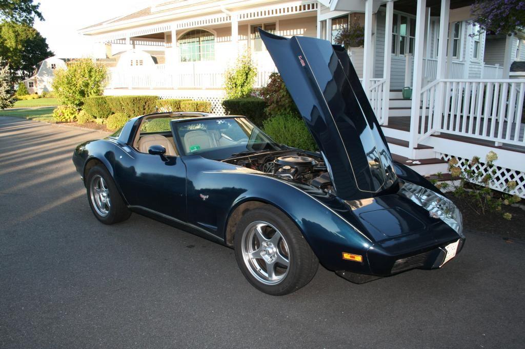

No offense taken
That looks much better, especially at this picture angle. I delete all the pictures that are taken at bad angles and make my car look funky, but I cant do that in real life.
To 15" vs. 17" wheels, that big a difference?
Both front wheels/rims fill the wheel wells completely now......
