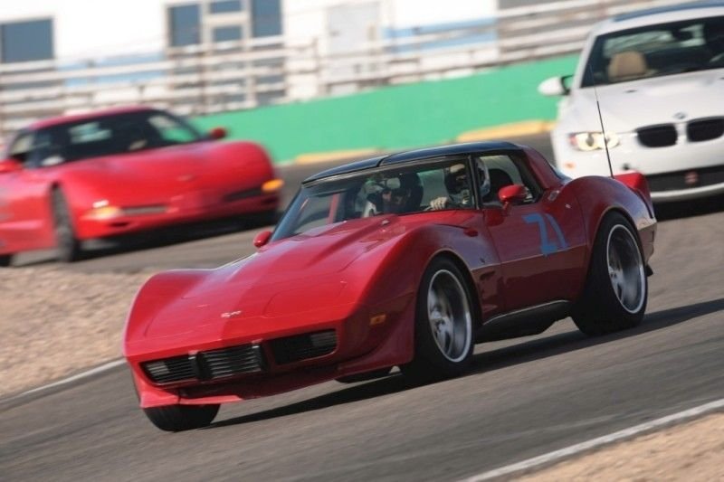

Baby is in my garage now as I work on the EFI again... so do not know the tire size off hand... but the rear wheels are 18 X 10" rims... I designed them myself and had centerline make them.. they are a 1 off.. the tread ware is 180, which is still way way to hard.. good for about 10,000 miles, or about 1000 miles on the track..and still peel through rubber all the way through 3rd. its funny... I can be doing 70mph down the freeway, just press down on the gas and lay down a sustained burnout down the freeway at 70!
I did have to remove the parking brake flange from the trailing arms... heck, i took the whole parking brake system out,, less weight. less problems with drag..
No rubbing... have a 5" backspacing on the rims..

Wow, that's crazy how big/wide those tires look and you got them to fit just by getting the parking brake bracket out of the way. I had rubbing issues on the frame and fender lip (both sides of the tire) by just putting a 1 inch taller and wider tire than stock (295/45r18). It must be the height that is causing the trouble.
I have a manual so I don't want to totally get rid of the parking brake system (even though its pretty bad) in case I need to park on a good incline, but I'm all about dropping weight wherever I can. I made some fiberglass headlight cover shells and got rid of the whole vacuum headlight assemblies with all the related components; I just mounted some small high powered driver lights in the grill area which work pretty good when I drive at night.
And what the heck is under your hood pulling a good burn out at 70mph with those tires?

mine is a manual as well... a TKO-600,,,,, 650hp... 680isf tq..... 2000-7000rpm working power range. 427 sbc parts wise about 13-15K$ (crank alone was near 3K$) not including assembly labor... As i did the assembly myself. just under 550hp at the rear wheels right now, (We own our own Dyno) and sitting at 3000lbs flat with a near 50-50 split on weight front/back.
We have 5 (used to be 6) corvettes we race, the C3, a well modified C4, 2 C5's one is a 427 Guldstarn and has been further modified and a C6ZO6 modified.... The C3 will lay wast to the all!:-)
We also race the Baja 500,,, that is fun!!!

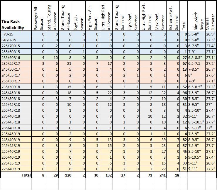

Originally Posted by SHIFT A
-There are hardly any options for the stock 27 inch tire height or taller (255/50r17 is it) with bigger wheels. Most tire options are shorter, and that's where you get the thin side wall look and bigger fender gaps (of course you can lower the car to close the fender gaps, but then you run into potential ground clearance and bottoming out problems).
Not true. I put this chart together a few years ago from Tire Rack's offerings. I don't think it has changed a whole lot since then.
But I'm sticking with 15" wheels. I like going old school. That's why I have a '73, not a '18. I'm intentionally sticking with old tech on mine, more fun and cheaper.
