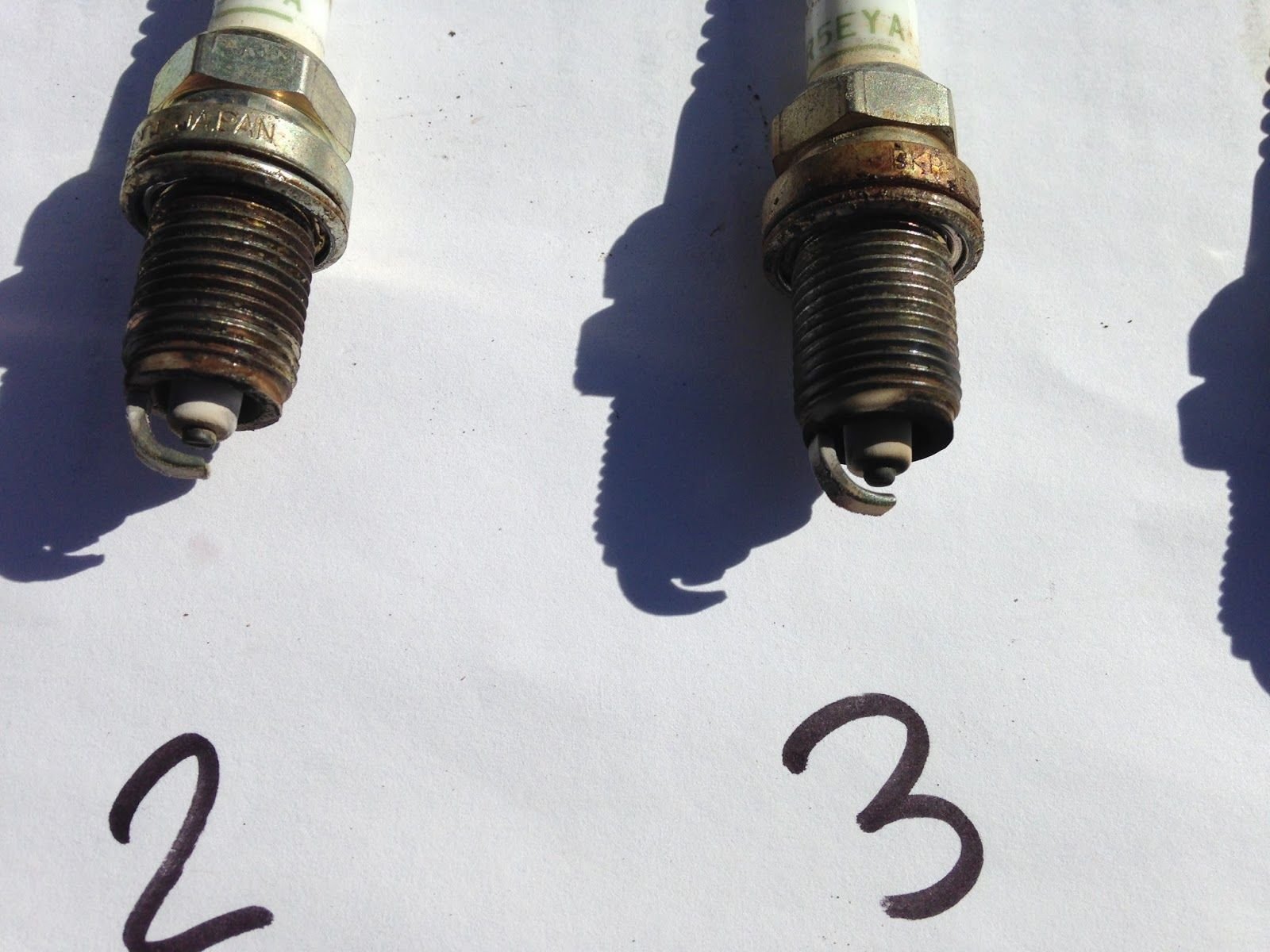

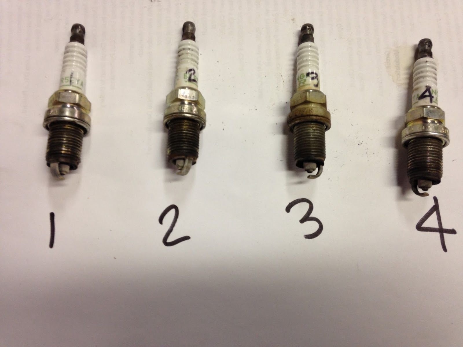

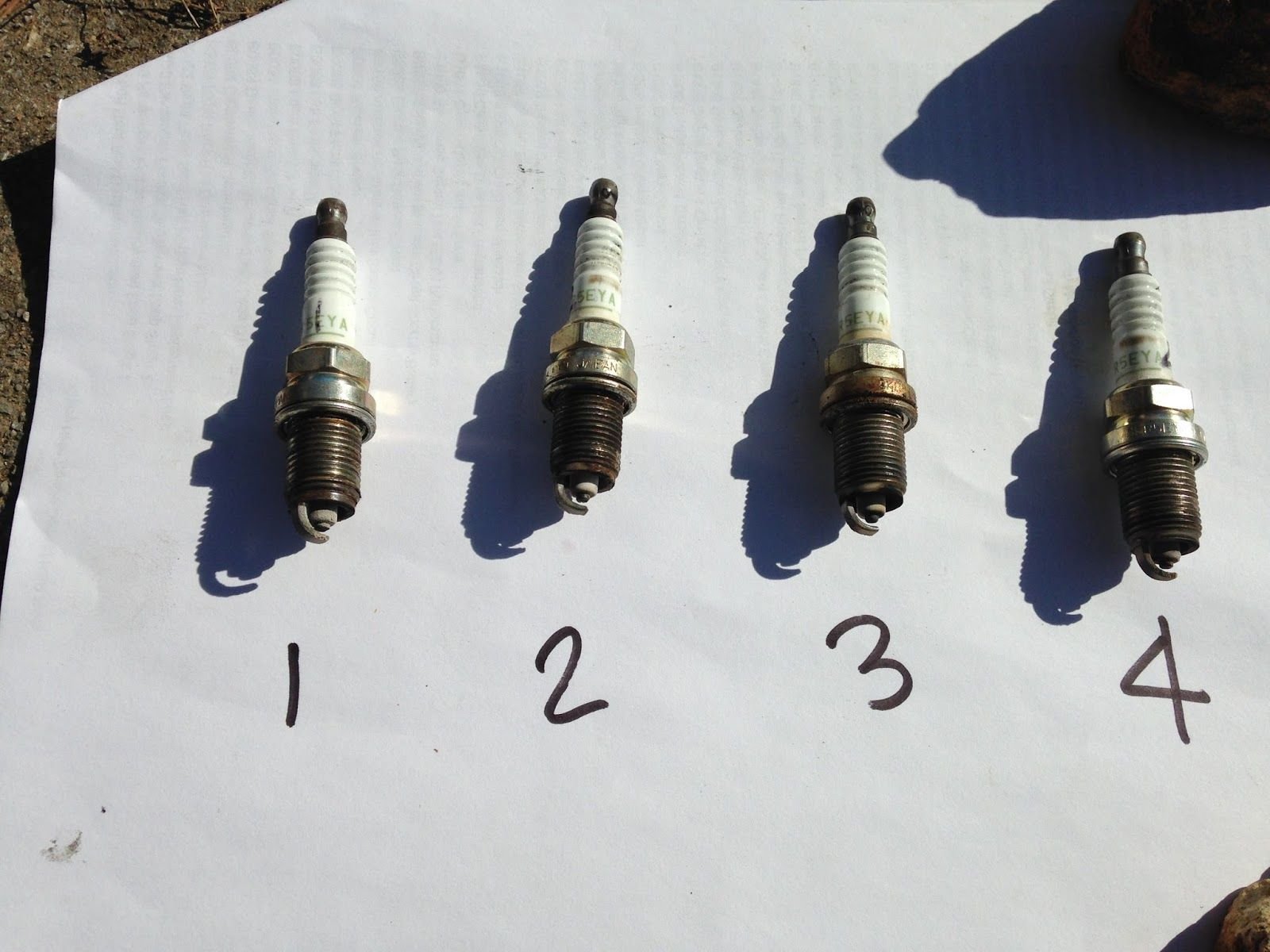

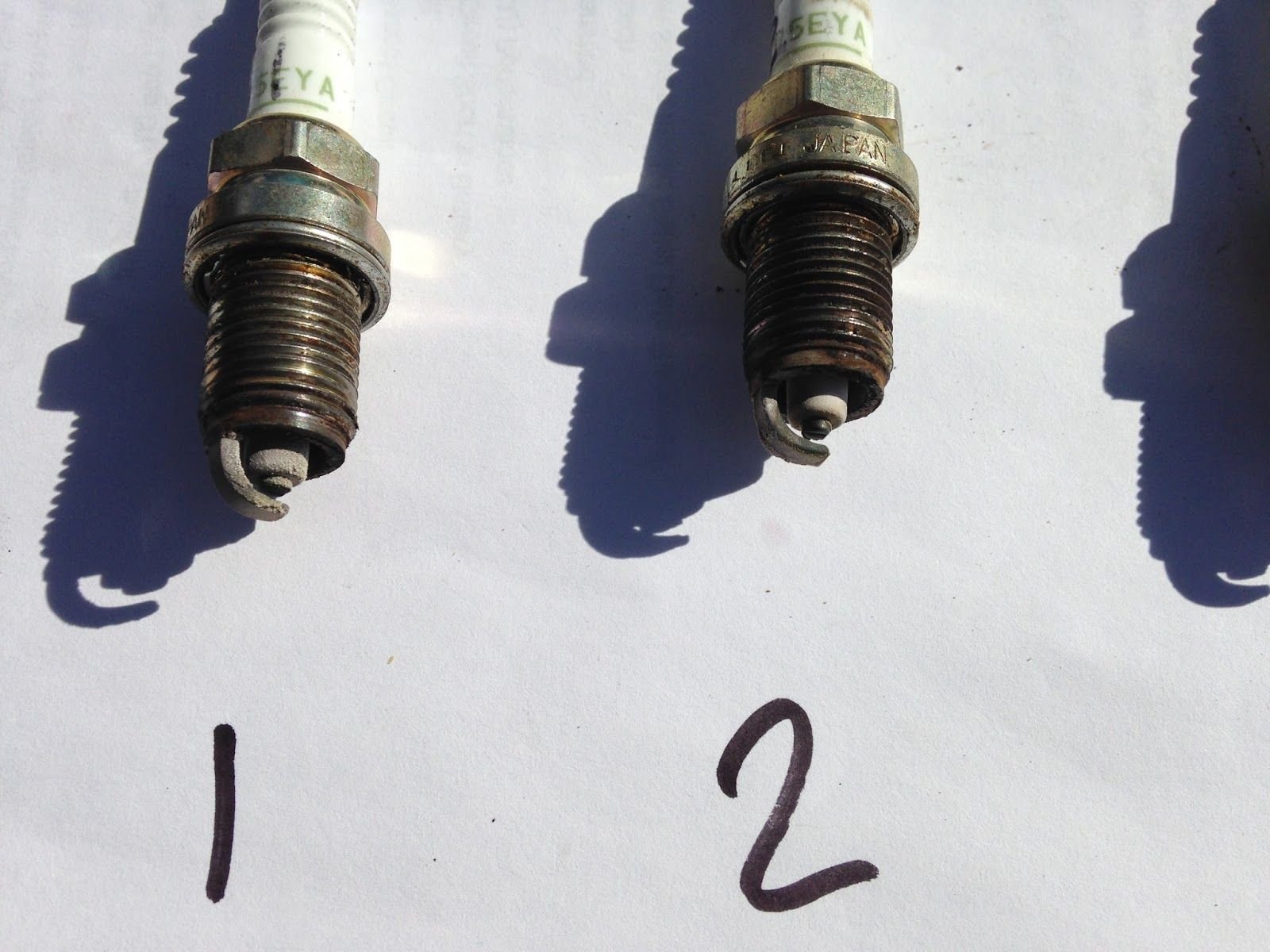

This is somewhat OT because these came out of my Tacoma 2.7 that I'm having issues with.....See pics below. I'll post the issues I'm having at the bottom. I trust Ya'll, I'm not getting much help on the Tacoma board.

Most likely a bad IAC and I think most shops would start by replacing it before doing any further diagnostics.
Not sure why you posted the pics of the spark plugs, but they look fine. A bit worn, but air-fuel mix looks good and no excessive oil.

I thought I might have had a blown head gasket.... Went thru many of the same issues on my last Toyota and that's what's it was in it.
