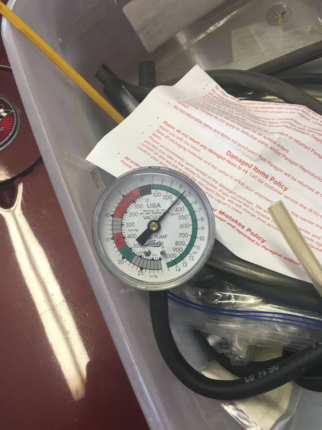

Is this gauge toast or can it be easily reset? Hate to throw away.

Just like a bathroom scale, if it doesn't start at zero, its toast.

Can the plastic cover be rotated to bring it back to "0"? My cheapo vac gauge has that ability.

remove plastic cover, pull indicator needle off, then reinstall at Zero.

Why did it get hung at 4.5 to begin with? I am going with toast (sourdough)

Can you remove the needle and reset it to Zero? Yes.
If you do, will the scaling be right? Probably not.
The gauge was likely over-pressured and components were damaged/distorted such that readings will not be accurate....even if the gauge appears to function properly.
But, before you throw it away, you could test its accuracy if you could borrow a similar gauge from a friend and hook both in parallel and connect to manifold port on running engine.

Actually it was in a cabinet in garage and ,Louisiana heat is the culprit I think

Unless the guts of that gauge are made of plastic (which I doubt), heat would not cause the gauge to recalibrate itself. Perhaps it got dropped, used as a pressure gauge by mistake, whatever. But, you could still test it against another gauge, as I already suggested.

It looks like there is a post there under the cover. remove the cover and see if that will allow you to er-zero it. The cover may screw off, but looks like it will pop off on that one.
