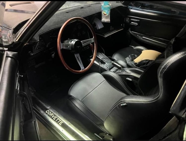

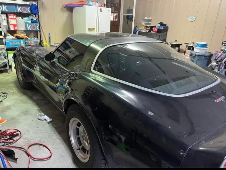

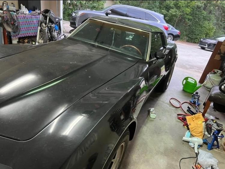

Years later, about to buy one of these in great condition running for 8k.
I have another 3k budget for engine. Shops around here in TN are pretty cheap. Without doing a whole swap and getting into that headache, what would you do to this 350 that comes in the 1980 Stingray to get another 50-70HP?
Swap cam and heads? That'd be about $1500 in labor for just those two things. What cam and heads could I throw on this without a lot of fuss?
Here it is; I'm going to have the car claybarred and paint restored if possible before having it repainted.
