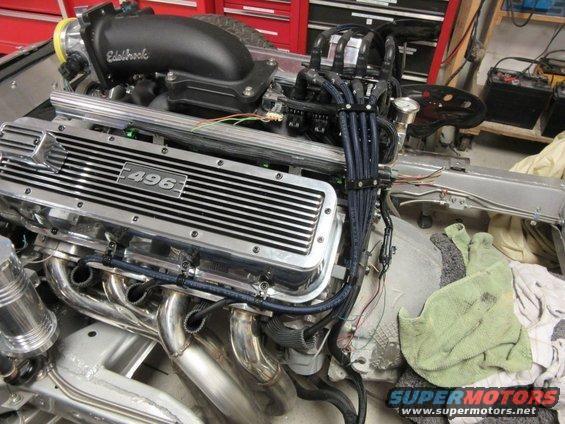

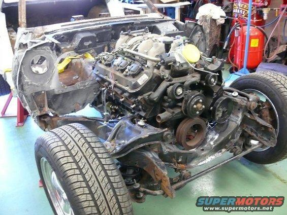

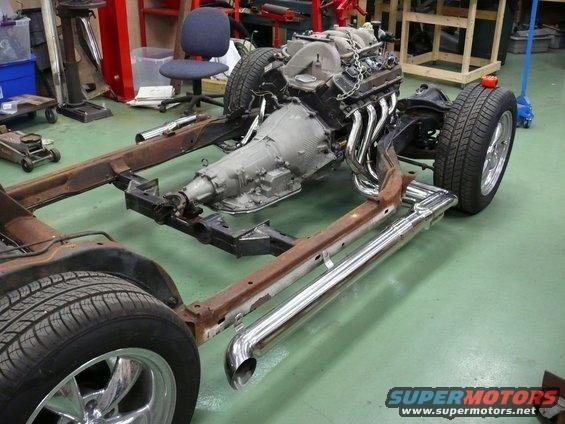

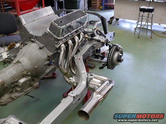

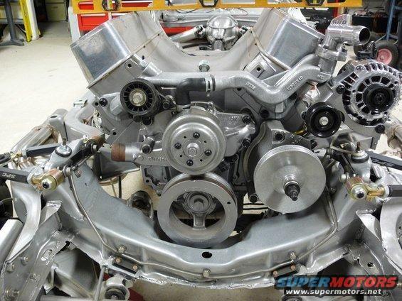

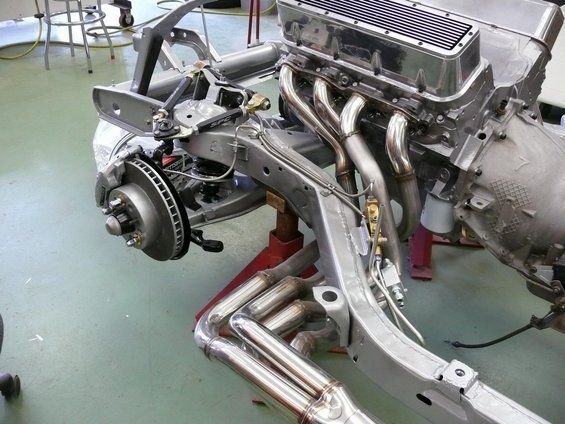

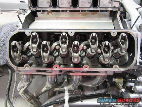

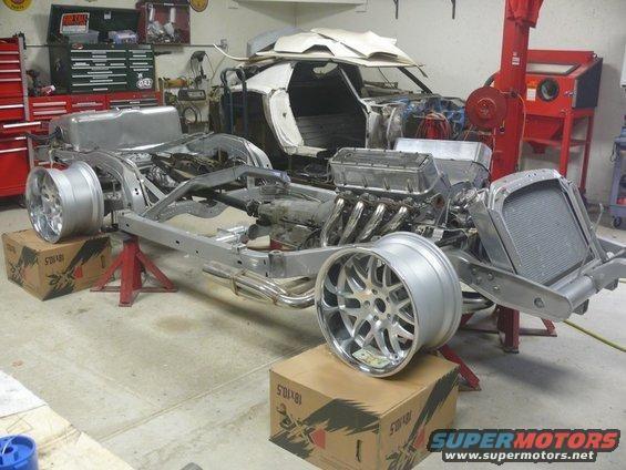

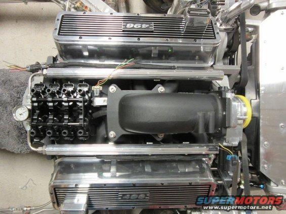

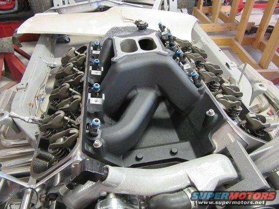

Did someone say 8.1L vortec it's not finished but here's what I have so far. Many mod's to get this engine in a Corvette.
