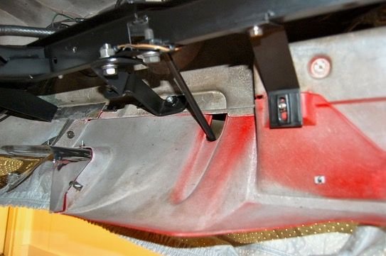

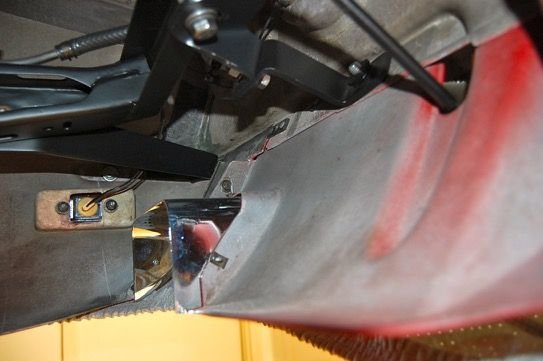

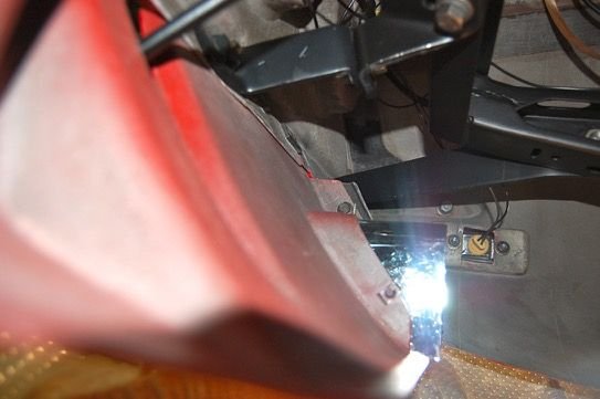

Anyone have a photo of the backside of a rear valance? The section that lives below/between the exhaust outlets. I need to see how the chrome trim for the exhaust outlets is SUPPOSED to attach to the panel.....mine were redneck engineered. The modification works, but it isn't proper. Would like to get it right. Thanks in advance.

Here are some photos of the rear valance/exhaust filler panel.
I don't know if they show what you're looking for.
If not, let me know what you'd like to see.

Thank you, Alan. Those photos are perfect, exactly what I needed!
