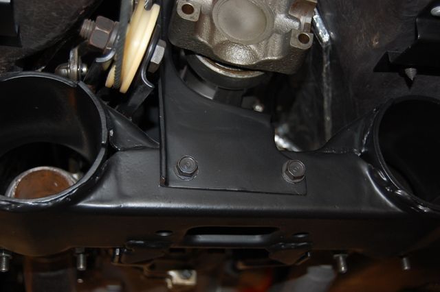

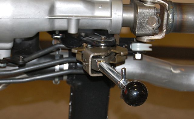

Alan, do you have a picture of the shifter bracket bolted up to the cross-member? I think that will help a lot.
Old Nov 29, 2017 | 06:32 AM
Alan 71's Avatar
Alan 71
Joined: Sep 2006
Posts: 31,269
Likes: 4,362
From: Westminster Maryland
Hi ta,
Somehow I missed that you'd posted the drawing for the alignment tool… I'll delete my post.
Regards,
Alan
Here's the shifter bracket bolted to the transmission crossmember.
The shifter mounted on the bracket…. 2 bolts.
One long through the shifter body and one short through a 'tab' that extends off the shifter body.
