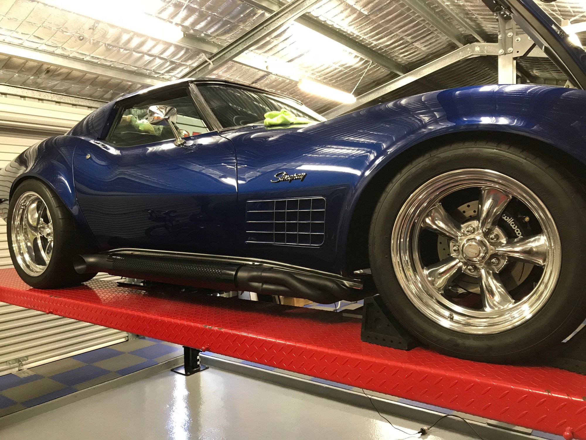

Old Dec 2, 2017 | 10:45 AM
3X2's Avatar
3X2
Joined: Jan 2000
Posts: 3,321
Likes: 523
From: home
Originally Posted by 69ttop502
X2, these are the best and make more hp than the Hookers. Still use a 4 inch sidetube but the collectors are under the car. More optimal length primaries.
Also available in 2" primaries- better size for a L36 than the 2 1/8" Hookers. Here's a picture,

Originally Posted by El Mago
Who sells the X2's?
"X2" is computer shorthand for "times two", as in make that two opinions in agreement.
With respect to the Stahl (ACP) headers, they look like their collectors are significantly shorter than the Hooker of Dougs. Would the Hooker/Dougs sidetubes work with them??
EDIT...I just took a second look at the picture of the Stahl headers, as I was closing the thread, and this just struck me. The Stahl headers are designed to be a drag race header, so the 4" collectors running under the frame and out to the side of the car, won't be a problem. But I could see then creating a HUGE ground clearance issue, on a street driven car. That's why the Dougs/Hookers bring the 1 3/4" primaries out to the side, before joining them at the collector....
Old Apr 23, 2018 | 01:18 PM
3X2's Avatar
3X2
Joined: Jan 2000
Posts: 3,321
Likes: 523
From: home
I had them on my 69 427 using Hooker 4" tailpipes before going back to the 67 side pipes. Yes, they are lower than the Hooker/Dougs/other brands with the collectors along the rocker. That said, the Stahl's make the most power. Be forewarned, the Stahl's may or may not fit with power steering and/or air conditioning.
