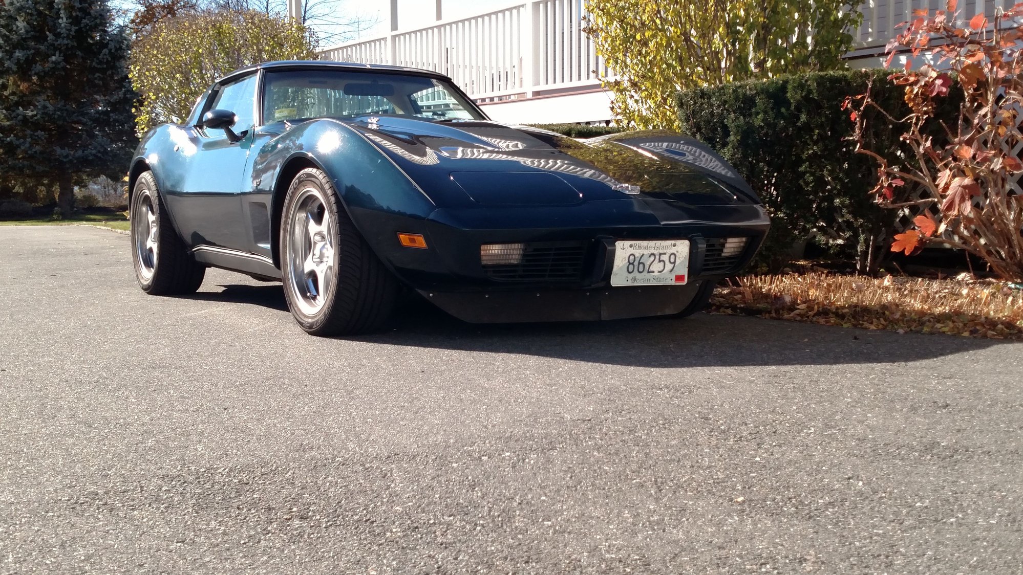

I think that the choice is easy if you have a stock suspension with stock springs and sway bars or lag there of in terms of a rear bar.....Bilstein HD's (B4) if you have a base suspension and Sports, if you have the gymkhana suspension. I use Bilstein Sports in the rear with my 360 monospring and Bilstein HD's in front with the 550lb coils....The ride is firm but not harsh.
Not a fan of the Koni's and unless you intend to race or autocross, I would not spend the money for the QA1's or ridetech shocks...just me. The Bilsteins are a deal.....
Here is my suspension from another post:
I posted this on my 78 L-82 4 speed in September...
I have a 78 L-82 4 speed car with the gymkhana sport suspension (67,000 miles) that I have owned for 34 years and I have tinkered with the suspension one part at a time over all those years to achieve the perfect balance of superb handling, steering response and a firm but not harsh ride. Not knowing if you have a base suspension (most likely since most did not have the sport suspension from the factory) or the sport suspension, below is what you need for truly sportscar handling with a great ride for your 78:
Front:
550 lbs front coil springs/1 inch lower than stock-$100
1 1/8 inch solid front sway bar (OEM Bar size)-$200
poly upper and lower control arm bushings-$50
Bilstein HD shocks-$150
Front Spreader Bar-$100
Custom blueprinted/rebuilt OEM steering box- GTR 1999-Gary Ramadei-$300
Rear:
360 monospring-$300
Bilstein Sport shocks-$150
OEM Style Rear Sway bar (not the aftermarket type bars. I highly discourage NON OEM/GM style rear sway bars)-7/16 or 9/16 or 3/4 inch (I have this one replacing the stock 7/16 inch bar)-$200
Competition adjustable strut rods with heim joint ends-$200
Total Cost $1750
This suspension will get you a FAR SUPERIOR suspension than what came on the car when it was new, X3 if the car had a base suspension from the factory. You will need to add 17/18 inch rims and tires (ZR rated only W/Y sub rating) later to maximize the superior suspension setup. I have ultra high performance summer only tires Front-255/45/17 ZR and rears 255/50/17 ZR's.
This car not only rides great, has tons of steering response, but can handle like a modern sportscar!^^^^^^^^^^^^^^^
As for the heim joint adjustable struts...makes the rear end feel more planted since there is much less camber changing under a load and has little to no detrimental effect on the ride quality.....................One of the best value upgrades you can make to the suspension....front spreader bar would be #1
