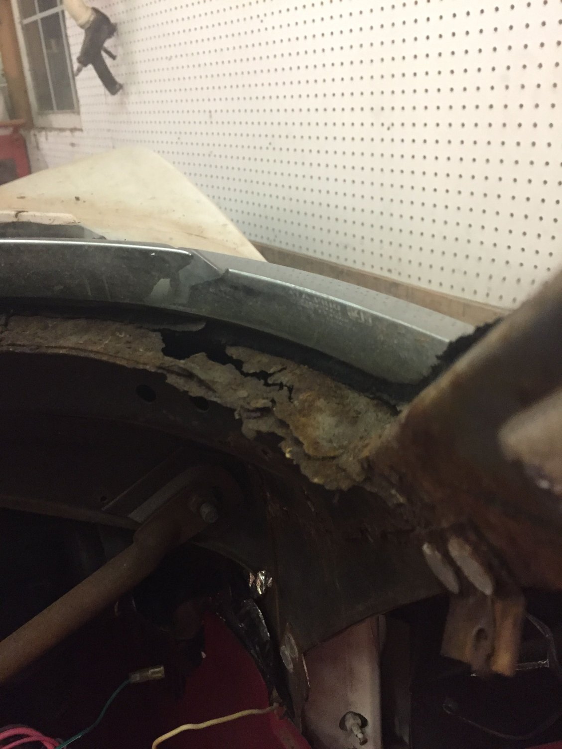

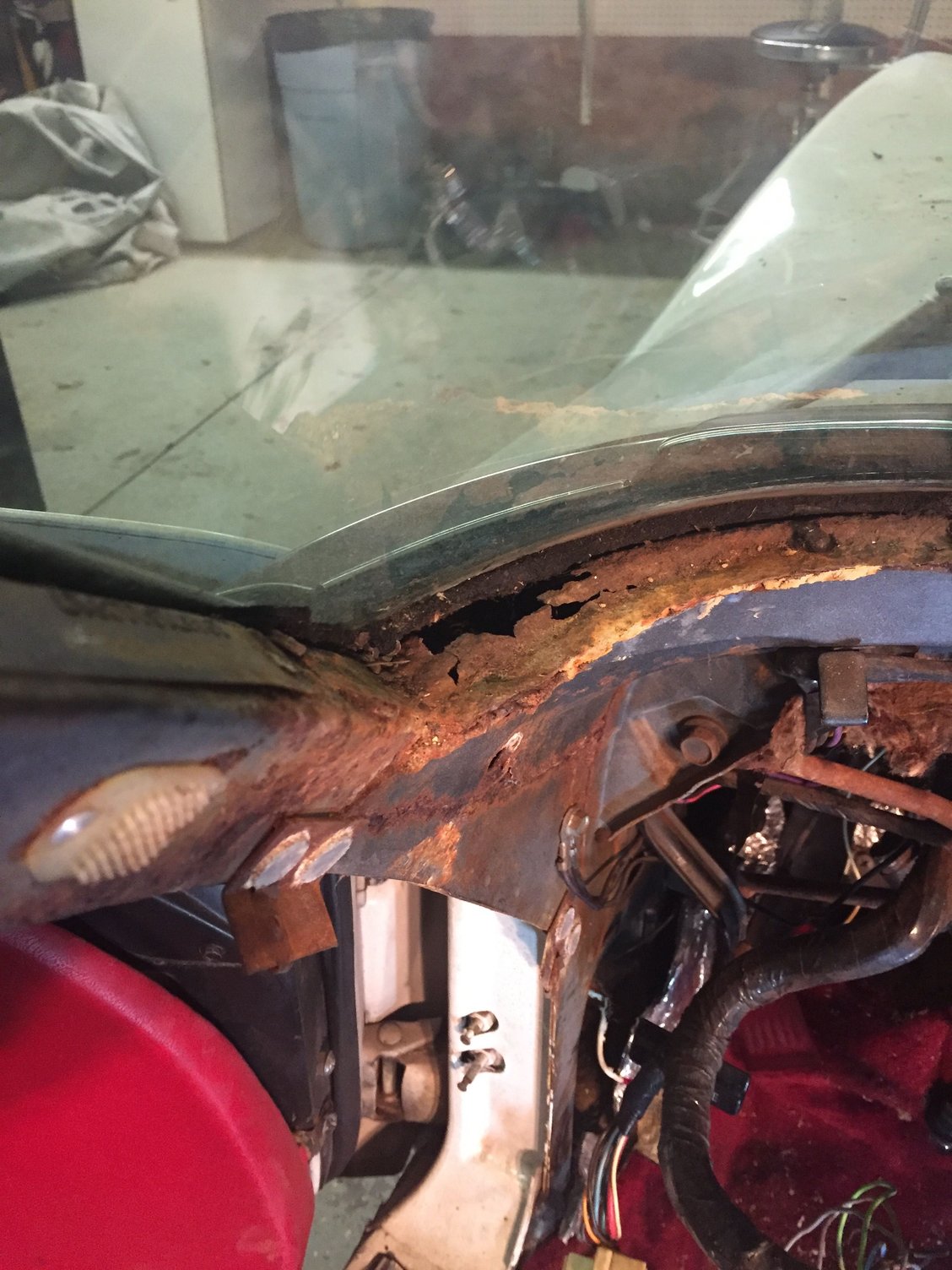

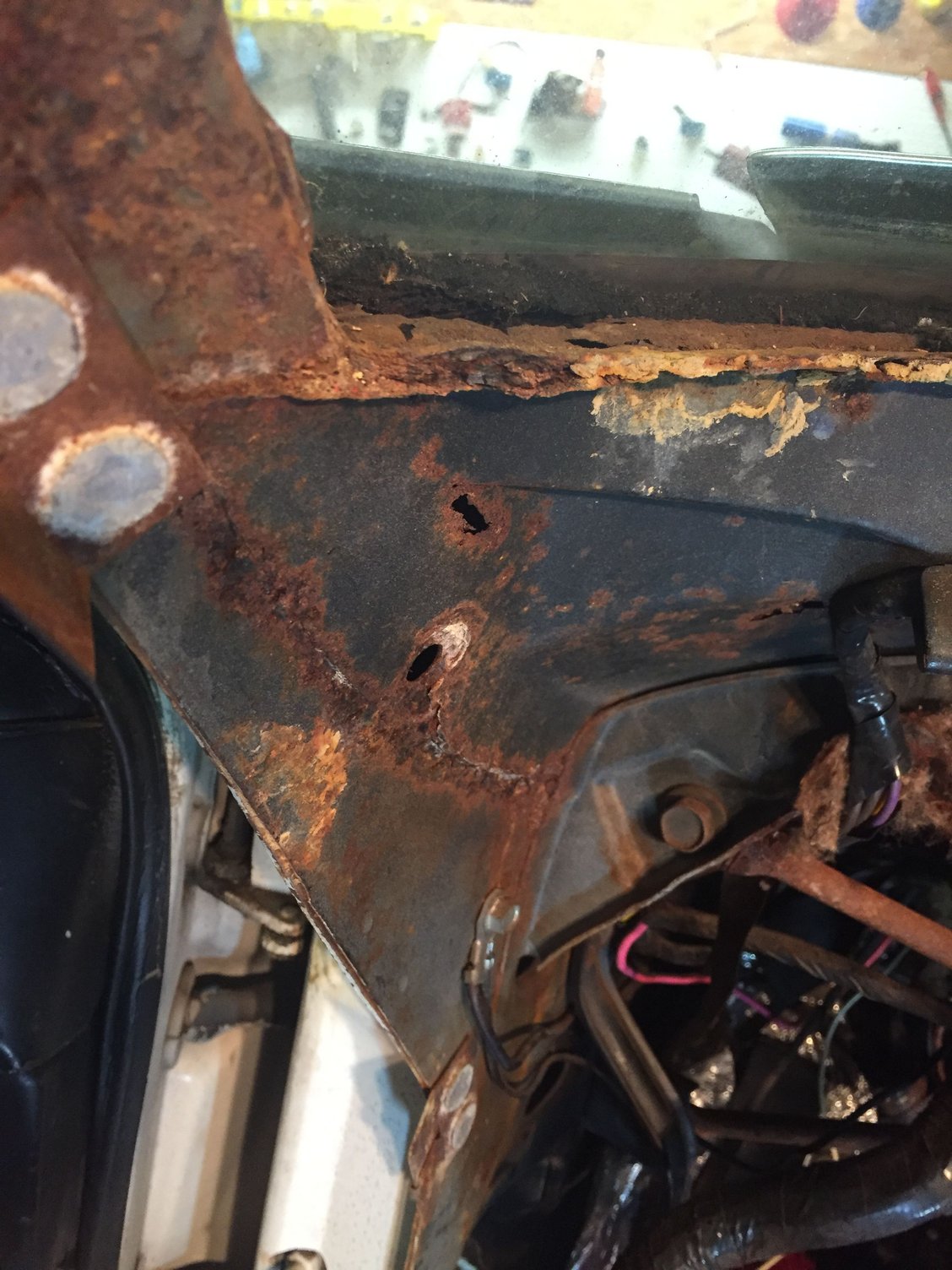

Title. Below are some pictures of the rust. What are the best options for taking care of this? Is this a structural issue?

Yes, that rust is a structural issue because the rust has progressed down into the cowl.
This is going to require some considerable amount of very involved work by someone familiar with the Corvette birdcage structure and some serious welding skills too.
Has the rust continued down the hinge pillars to the #2 body mount and rocker channels?
What car is this in, (I see it's a convertible),.... how 'attached' to it are you?

I am not expert, but I think I can say yes, that is structural. Ask yourself, if the windshield is removed, do you think anyone would try and put in a new one, knowing the rust issues you have? I had rust in the upper windshield frame and had it repaired, of course what I had does not compare you what you have. If you have that much damage, I have to believe there is more you're not seeing.

I am quite attached! It’s one I’ve had for almost 17 years. Just have now taken the dash apart for steering column repair and found this. Where you see the rust is as far as it goes. The rocker panels are fine. I will check the body mount.

Oh dear , that's a bad corner piece .
pulling the windshield will let you see better , but once its out , no-one will put it back until it's fixed . I would also be worried about how badly rusted it is further up the side .
If you look up Big City corvettes , they cut up pieces from old vette bodies (metalwork.) I have actually rang them and ordered specific sections for rust repair .
Are you possibly going to have a go at repairing this yourself ?

There are many ways to attack this issue, but none will be cheap. Pulling the windshield would be the place I would start, but that's not going to be the finish... Hate to see it and say it.
To gain access to the lower pillar you'll either need to remove the front end from the car or make a cut in the fender (which will show after the car is repaired and re-painted).
If you remove the windshield you'll gain some access but not enough to do the repair correctly on the lower frame. Since the rust is in the pillar as well as the lower section, I'd bet money that there are holes in the top as well.
The picture below is of a 1969 convertible we did about 10 years ago and as you can see this car was in about the same shape as what you have. Our customer elected for us to just cut the end of the fender off vs. removing the complete front clip. The customer was the original owner of this car and we still work on it to this day.
Another thing you might want to do is go read this.
http://repairs.willcoxcorvette.com/1...-installation/
Good luck with this, fixing this is not going to be easy. Since the car is a 1971 the lower sections for the frame is not available, on the 69 we had to fabricate them. But they are now available for the 1973 and newer cars and can be modified to work as a replacement on your car.

Do you have pics of the area behind the kick panels....? I'd be interested in seeing how they look....?

I am no welder by any means. I’ve got a local guy who mechanics/welds/fabricates that is familiar with corvettes who said he could fix it up when I sent him those pictures. I wanted to post here to get some other owner’s opinions/experiences. Thanks for the tip on Big City. I will give them a ring.

I’m heading to my shop tomorrow night. I will snap a few more pics for you guys.

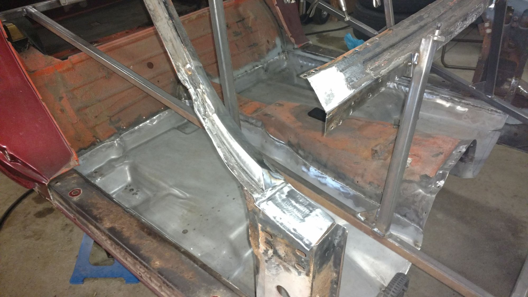

yeah , I have only done one of this type of repair ,but it wasn't as bad as this one of Fubba's but I think his repairer of choice would be looking at removing the firewall for proper access , have you guys ever done a complete firewall removal with the front clip still attached ? Is it even possible ?

It wasn't too bad of a job, just time consuming.
I had to do both sides, took a couple of weekends.
Removing the clip and firewall took a weekend.
