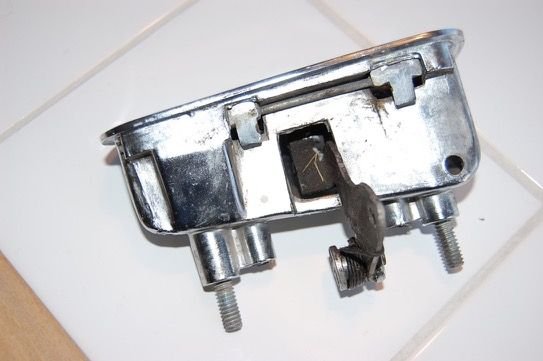

Hi dear friends,
I really need a little help.
I have a problem with my doorhandle, this one falls down. See picture.
Maybe there is a spring broken.
I want to disassemble to see what is wrong.
But I have a lots of problems to remove this doorhandle.
The two bolts at the bottom of the doorhandle I have removed already.
The door handle is loose, but I get them not lifted up.
Is there a video on the internet how to do it?
Anyone have experience with this?
Thanks for your replay,
Claudio

I had trouble getting mine off too. The hinge pin had slid over to one side.
See if that is your problem.

Hi CS,
Have you disconnected the rod that connects the the lever to the latch mechanism?
If you have, the handle needs to be pivoted/rolled as it's pulled up out of the door in order for the lever to clear the fiberglass.
It can't just come straight up and out.
Regards,
Alan
Notice how the lever extends quite far beyond the side of the handle. That's what traps the handle in place.

As Alan pointed out if you haven't disconnected the rod then all the pulling and twisting won't matter.
Here is a write up and also a youtube video. Part #2 is what you will be looking at:
http://www.superchevy.com/how-to/4696/
