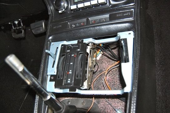

does heater control mount to the shifter console trim plate or is there a bracket I'm missing

Hi vs,
What year car?
That MAY affect how the controller is mounted.
The 68-72 heater defroster control mounts to the bracket that the vent-levers are a part of. (2 screws).
The same screws that mount the front of the shifter plate mount the bracket in the console.
