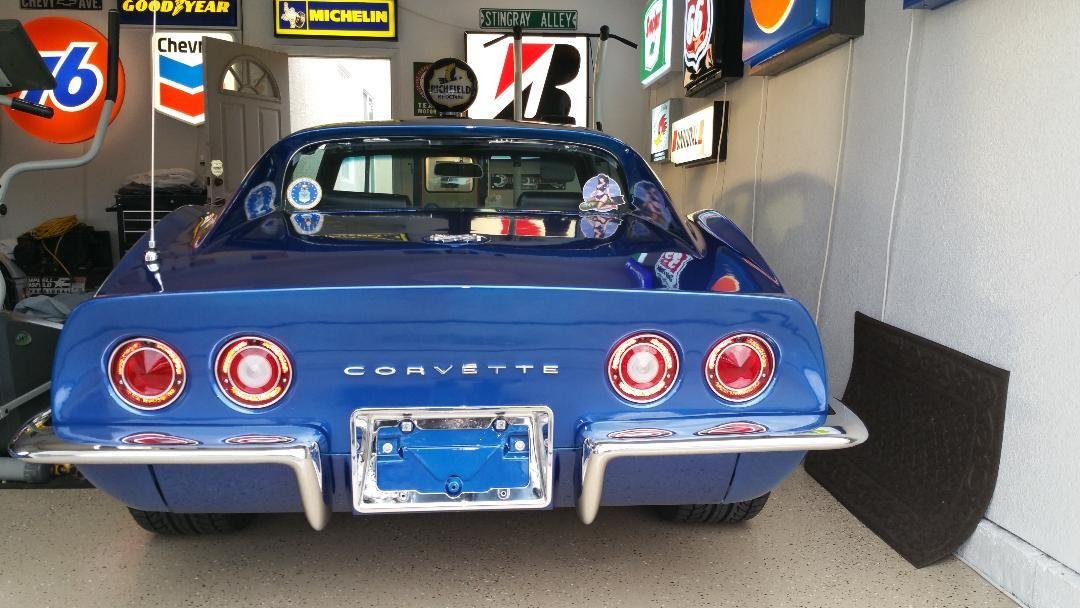

After weeks of attempting to fit 18x10 / 5.25" backspace Rambler wheels, I finally succeeded by getting the Sharkbite suspension installed! My first attempt trying to fit the wheels was to cut off the parking brake bracket on the stock trailing arms. The 18" wheels cleared the VB&P spring with no issues, but even after cutting off the parking brake bracket the tire had clearance issues on the stock trailing arms.
The next plan was to swap out the suspension. I decided to go with the Sharkbite as the car will never see track duty and I wanted the bling factor! With that, I had all the suspension parts chromed...
This required baking off all the powdercoating. I also decided to add stainless steel flat washers on most bolts as SS washers are thin and would protect the nice chrome finish from marring.
I then decided to replace the trailing arms with offset ones. After carefully researching all he aftermarket trailing arms I decided to go with Van Steel offsets with Johnny Joints. This required two additional brackets from Speed Direct which I felt were very costly for what they are. Also, because the ones that came in the kit could have been cut to be made like the second set I had purchased. These additional brackets then had to be professionally welded squarely onto the ends of the Van Steel trailing arms.
After numerous little headaches as usual working on these cars , I finally got the entire suspension installed. I set up the rear with the suggested 1/8" toe-in and zero camber for now. After driving a little, I definitely can feel a difference as the car is much more stable. I have ordered the front Sharkbite coilovers so I can set the rake a little lower in the front. Hopefully after a good alignment the car will finally handle like it should.
BTW; the rear VB&P sway bar was barely touching at the mid-point of the rear tires. According to Speed Direct, most don't run one, but I am planning on taking the bar to a machine shop to have it bent just a touch on each corner bringing the ends in about 3/8 of an inch.
B-R

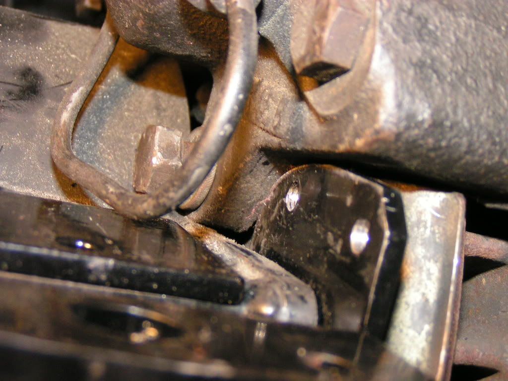

I ended up wrestling with mine for a solid week too. Speed Direct was less than helpful and really wanted nothing to do with me "after the sale" IMO. They did send some franken-brackets after the fact that looked like Helen Keller welded up. I had clearance/fitment issues out the ying/yang....here's some pictures of the BS I had to correct on their direct fit suspension. It does look good though. I've since replaced the calipers with Wilwood D8's.
