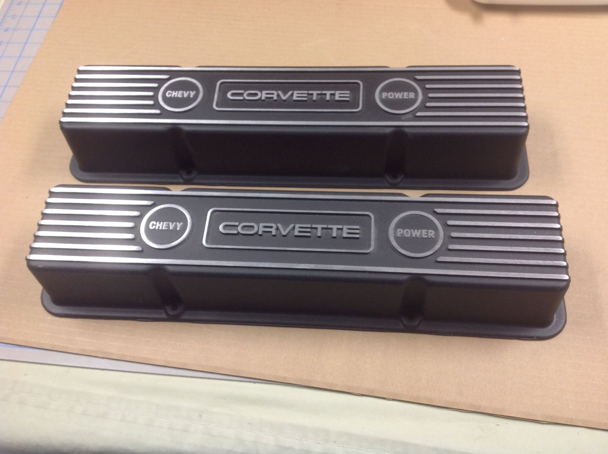

Does anyone know who makes these valve covers and what they go to?

Look like chev small block 350 covers. Speed shops sell them, do not know the manufacturer but lots of different ones are made

PML maybe ? yourcovers.com

Could try sending a PM to bluegtp and ask where he got his.

Problem #1. No breather holes.
Problem #2. How to add oil?
Problem #3 No PCV hole
These must be for early SBC that would have an oil fill tube on the intake (327) maybe.

I have a set of these that I got with a bunch of parts, no idea where they are from but the "chevy" and "power" decals are made to be popped out so you can put in a grommet to resolve any of the above questions.

Ok. Gottcha. Kind of takes away from "cool look" of the wording though, but I understand.

Oh, I agree which is why they are sitting on a shelf and I am using different valve covers =)
