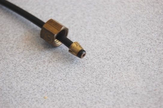

Hi S3,
Here's a photo showing the tiny fitting that pushed into the line itself.
Regards,
Alan

Originally Posted by Alan 71
Hi S3,
Regards,
Alan
Is there anything you DON'T have a photo of?
