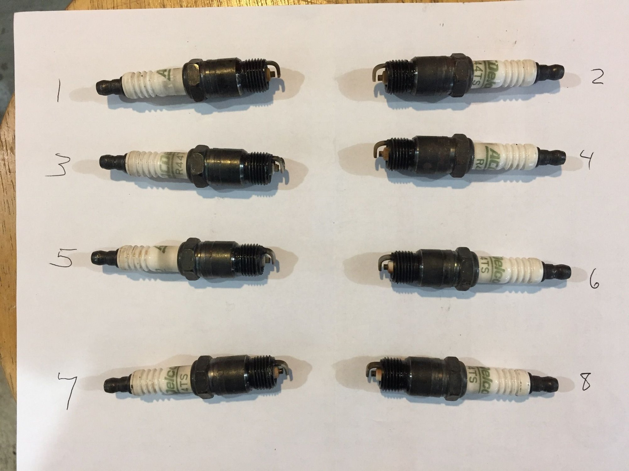

Here are the results. I did a dry test then injected small amount of oil into each cylinder and re tested. All plugs had a light tan color at the tip of them. I think the numbers are not bad. Let me know.

Thats good. Only about 10 lb difference between cyls. About 5 lb increase with oil. Means the rings are A-OK.
# 3 & 7 did not respond to the oil introduction but the plugs look ok.
And sometimes a few lbs lower is just the battery getting tired depending on which order you tested cyls in and if a battery charger could keep up with the cranking.
