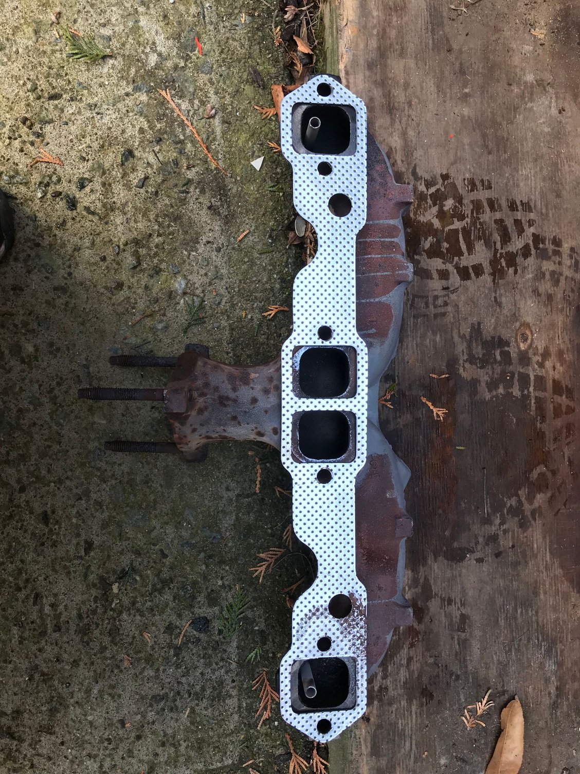

I’m fairly certain they sent the wrong gaskets

Yup. I'm thinkin' so. Looks like something for at least a 1 3/4" header or larger.
You likely need the 1 5/8". But you need to compare it to your headers not the Exh manifold.

Maybe not......I remember Hooker side exhaust headers having a squarish flange inlet......regular gaskets do not work......
Hold that same gasket over the header flange and look at it.....
Remember....you are sealing the FLANGE....forget about what the port looks like.....

Look closely at this photo:

The ports on the head are round and I think the square gaskets are a little to big and leak out the bottom.

Yup, way too big. I believe those are 1 3/4.

I just installed the Jegs version of Percys gaskets because there seemed to have more gasket material around the holes. The leak is 98% eliminated. I think the carburetor makes more noise. I’m not sure if I’m going to pursue this more or remove the reverse flow mufflers and install glass packs to cover what little leak there is or possibly take a saws all to them and take them out🧐

I wanted to thank everybody for their help. It turns out I went with 1 inch bolts and Hooker Header Gaskets. They fit perfect and sealed perfect to this point. I tried the re usable/never leak gaskets but they didn’t work for me.
