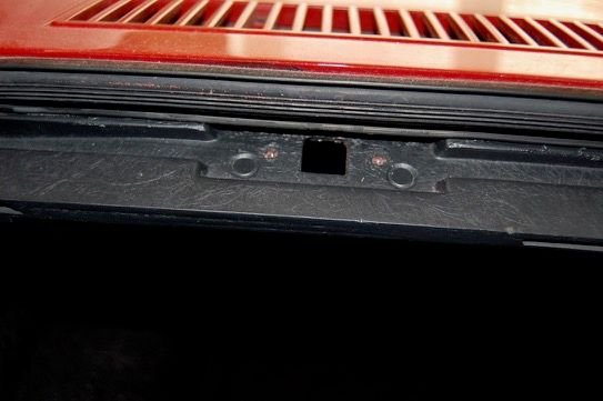

I am retrofitting the rear window in my '75 to the 68-72 style removable window. For anybody that has the interior of their 68-72 coupe pulled apart, I would be interested in how the two lower plastic pieces are attached to the body window frame, are there speed nuts clipped in there or do the screws go into the metal frame?

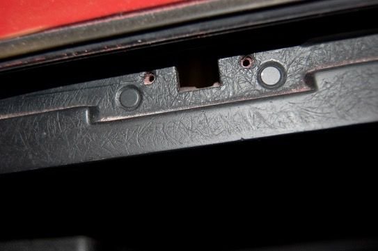

Hi Scott,
I'm thinking there's a 'tapping plate' under the sill to receive the 2 screws?
Perhaps these will help.
Regards,
Alan

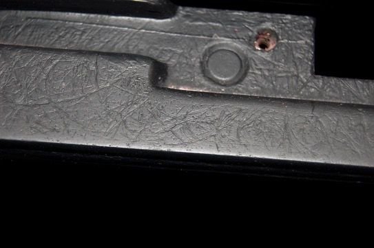

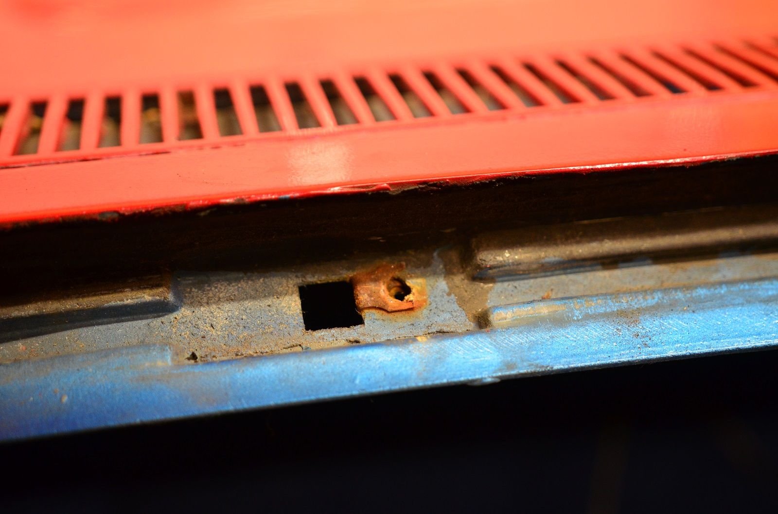

Thanks for this. From what I can see I need to drill an extra hole for each latch to match the existing hole. My car has a speed nut there but I don't think it was ever used. Can you confirm that there are speed nuts that are used to mount that hardware?
Scott
Originally Posted by Alan 71
Hi Scott,
Regards,
Alan
The current state of the lower rear window frame on my '75.

Hi Scott,
There's a rectangular tapping plate under the fiberglass 'sill' that's held in place by 2 rivets.
Regards,
Alan

Perfect! Thanks!

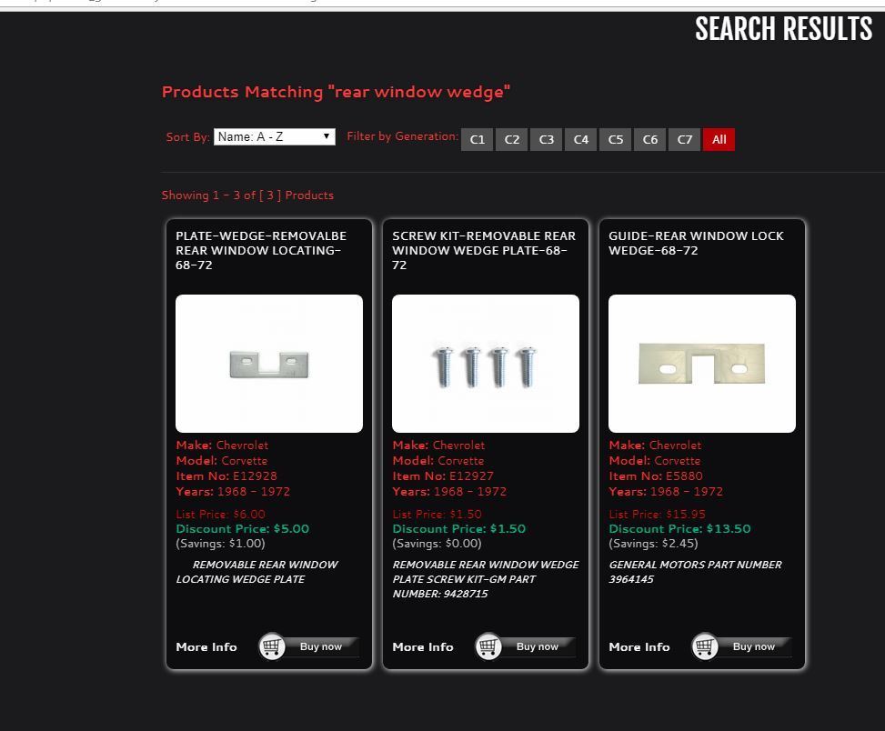

Looks like Corvette Pacifica has the wedge, and metal plate

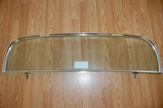

The glass for the removable rear window is set in a polished aluminum frame.

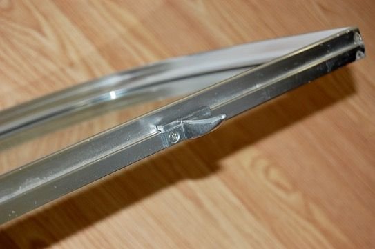

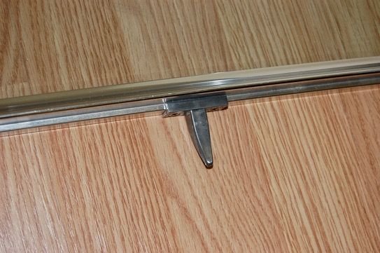

The glass is held in place by 2 'pegs' attached to the bottom of the frame... they fit in the 'receivers' shown in this thread...and 2 spring loaded latches across the top.
I'm unsure but I'd think the glass is a different size than the piece for the later fixed glass.
There is also a fiberglass tray that's mounted right below the rear deck to store the glass in when it's not in place.
Regards,
Alan
Interior side of window.
One of the latches.
The pegs.
