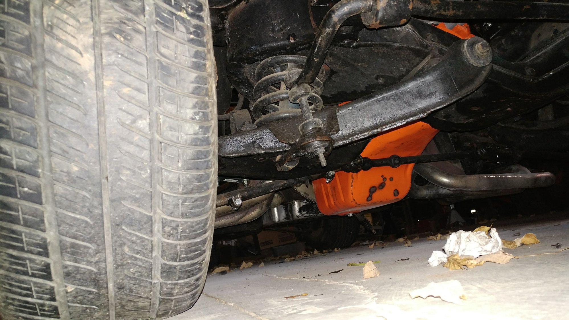

I used a truck oil pan with a front pickup tube and baffled the pan. I snapped a few dimensions if they help.

Truck pan from underside. FWIW. I have a jeep box going in so there is a little more space. Having said that, there seems to be plenty of room.
