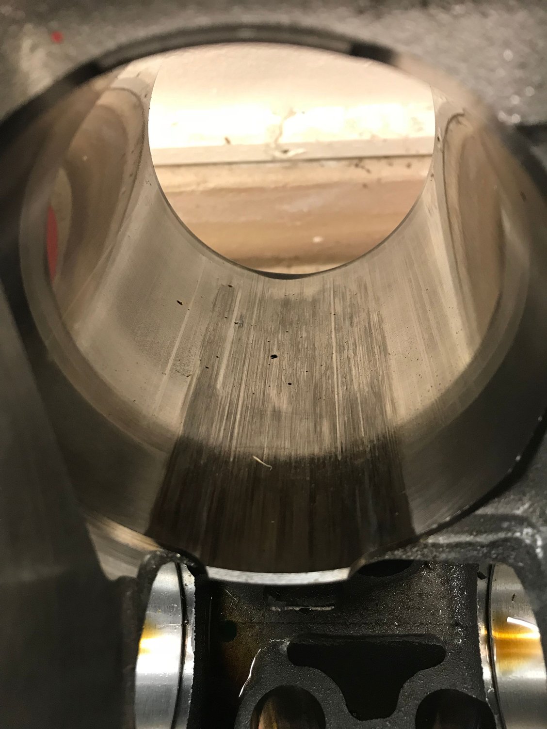

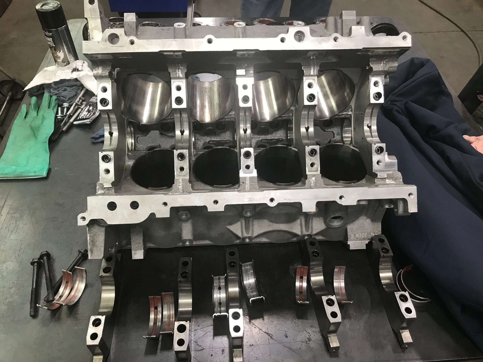

Bee Jay, that engine had bearing material pumped through EVERYTHING.... so there is going to be scratches/trash EVERYWHERE...
You are going to have to clean the block really well, it needs to be hot tanked for sure to start. Then line bored. All of your main bearings got trashed because of the rod bearings failing and sending trash through the whole oiling system
At a minimum, the block will need to be cleaned, line bored. The two smoked rods will likely need to be replaced, and the replacements needs to be resized. Obviously whatever pistons are damaged will need to be a replaced and a clean up hone on the cylinders..
It shouldn't cost TOO much to fix it but...definitely not a budget repair. Now is a good time to have the valve guides replaced and a good valve job. Along with a good cam and valve springs.
I'm not buying the "lead free" bearings were the initial cause of the failure. Technically, the bearings should never touch the crank anyway... If it starved for oil, it would have killed any kind of bearings. My guess is, the oil was filled up incorrectly on one of the oil changes, if not that, then something else happened to the pump/dry sump system.
LS7s are nasty engines, especially when cammed...its worth fixing it for sure and will be killer in your 79'..

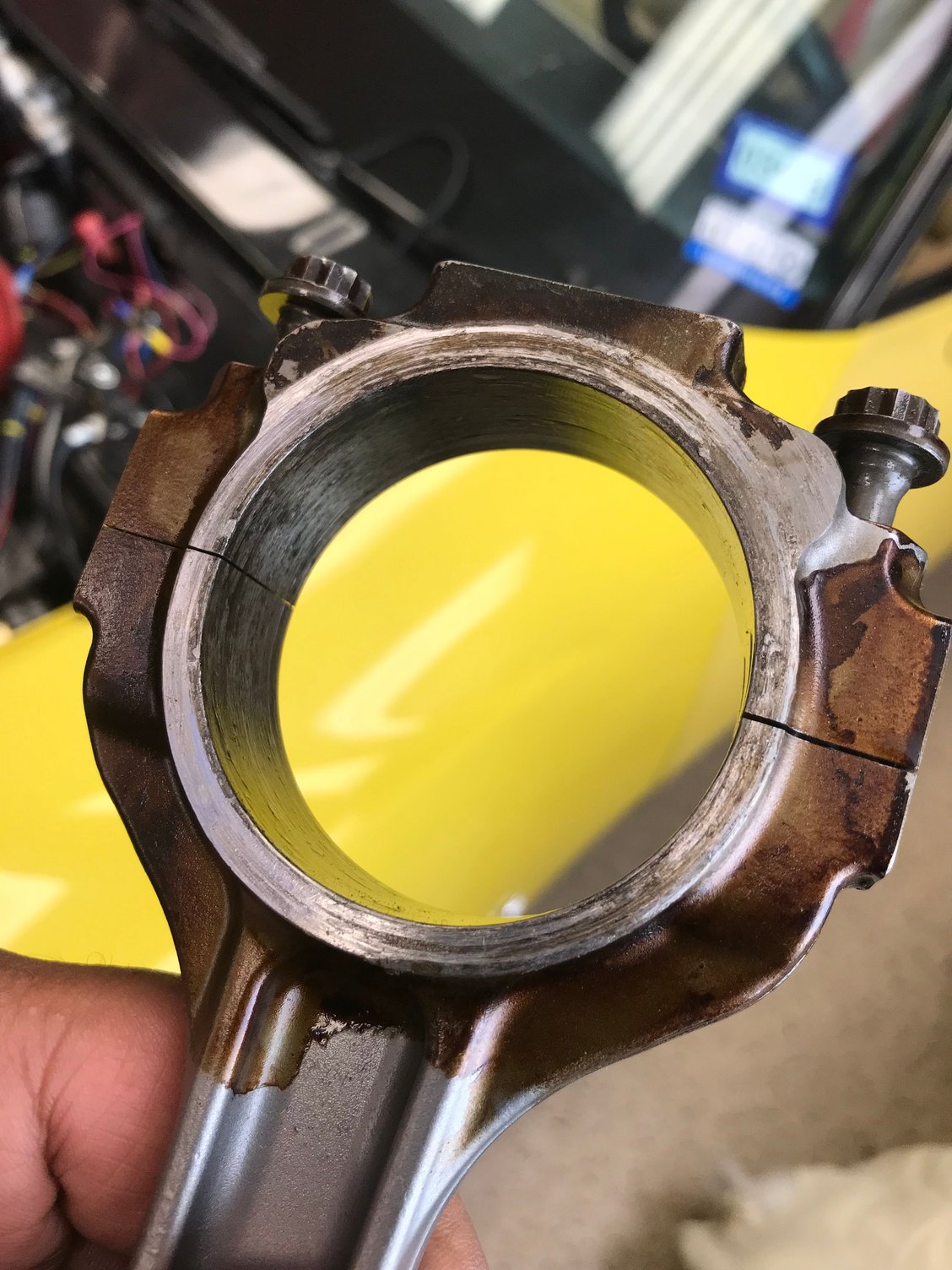

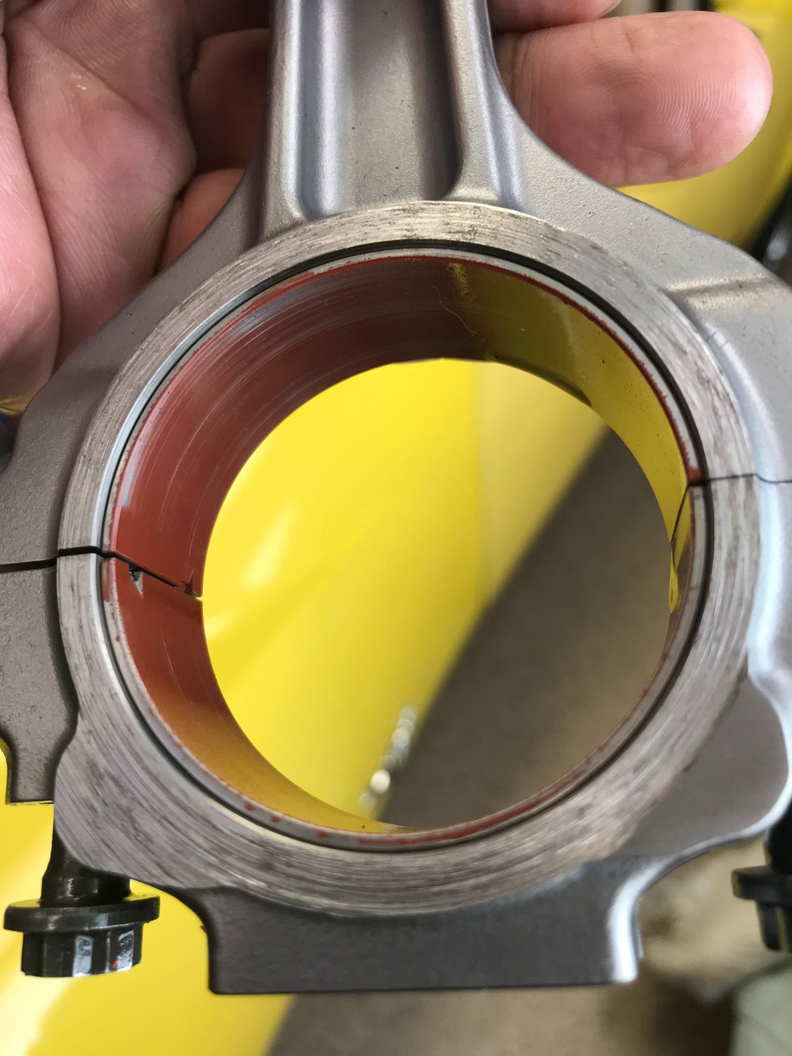

More carnage! Look at the side of the rods! And here is the #6 bore. Maybe I should get my $150 back.

Has the motor been apart before?
It looks like you have a mix of old style rods and the newer notched ones.
No,the motor only had 7,000 miles on it when I bought it.

You could just get a set of Callies Compstar rods for about $600 a set new, likely going to need to bore it after seeing that one cylinder, at that point you may as well buy some Wiseco pistons to the tune of $900 with GFX rings. So about $1500 for the rotator, then probably $500 worth of cleaning machining on the block, balancing etc. Absolutely buy a new oil pump, new oil hoses and a new dry sump tank....do not reuse ANYTHING that's internal.... because metal will be trapped in it. Even lifters.
Realistically, I could see it costing about $3k to properly rebuild the bottom end with forged parts and new necessary parts. (oil pump, cam/lifters/trays, timing chain set etc...) plus fixing the heads... Even if you end up at $4k total, that's pretty cheap for a forged LS7 with a good cam and repaired heads... And it will make over 500rwhp in your car... H/C LS7s usually average around 550-560 rwhp, and the engine is light.

Lots of places to buy rods and pistons from. Honestly, I'd have the block checked out first to make sure that cylinder will clean up. There is not much meat in the liners to bore these things... You MAY get away with .010" over, and the pistons will be custom order for sure.
I had to bore an LQ9 block over .005" and ordered custom Wisecos and it took a month to get them.
With as much damage as occurred, you see why GM replaces engines as opposed to "fixing" them and hoping nothing comes back to haunt them in the future.
A crate LS7 is about $13k and still has the valve guide problems. The ONLY fix for the valve guide problems is aftermarket guides/valve job to true up the guide to seat relationship.

Damn, the crank is bent. 45 thousandths out. Now I know why it was so hard to rotate. They will inspect block, rods, and pistons next. Anyone know of a good LS7 crank for sale? I will probably need the whole reciprocating assembly. Damn.

The rods are bad. Hopefully a 5 thousandths bore will clean up the one bad cylinder. So I’ll be needing a complete LS7 rotating assembly. Any recommendations? Reasonable recomendstions?
