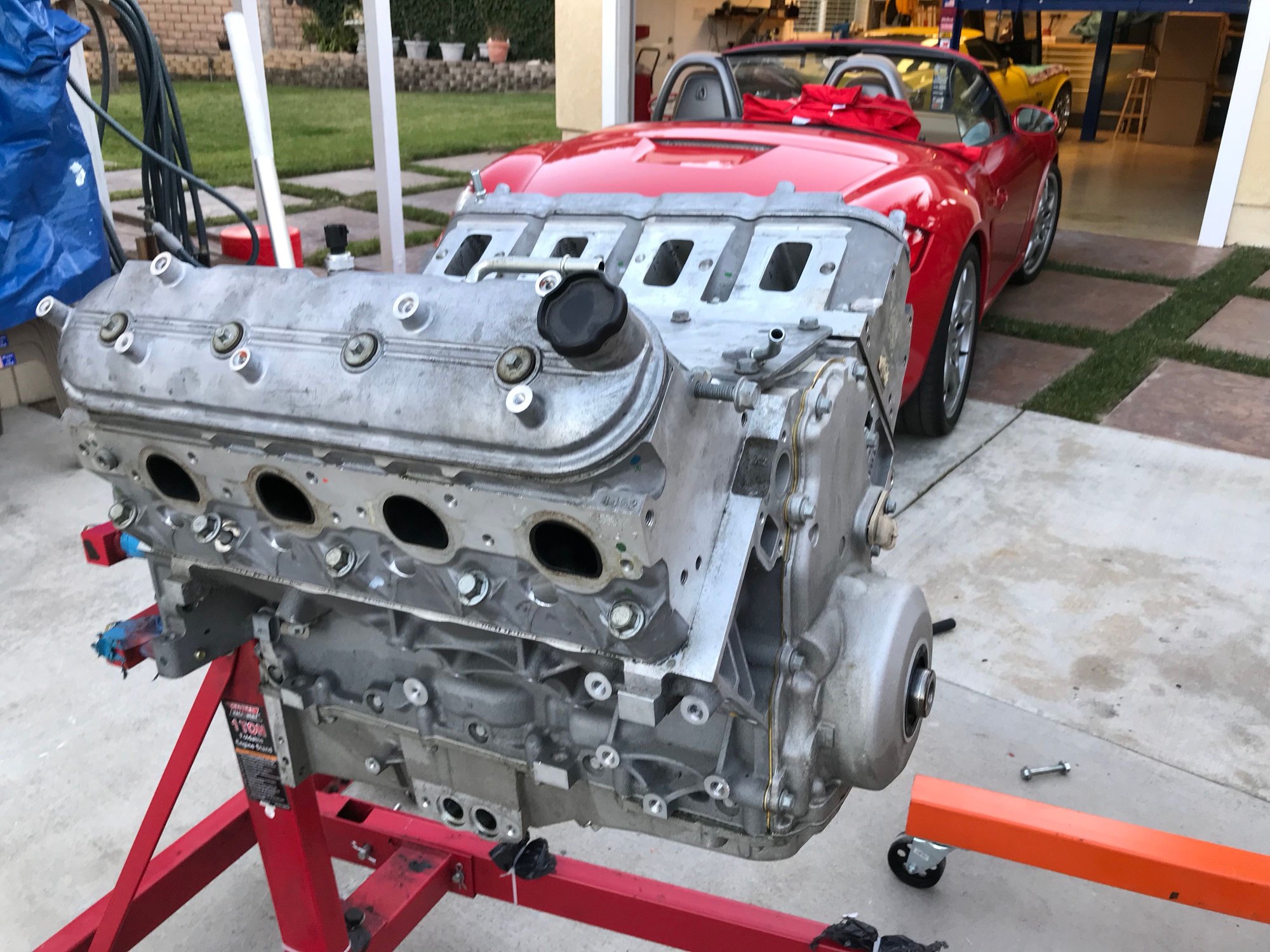

Hi guys. I blew the motor in my 2013 Corvette 427 Convertible. Luckily, it was under warranty and I got a new motor. I got the core motor, so I have a 427 LS7 motor with a bad crank and two bad titanium rods. The motor only had 7K miles on it when I spun the rod bearings. So,.....resistance was futile, but after 20 years of resistance, it looks like I'm doing an LS conversion. 100 more horsepower, and 100 lbs less weight. Stay tuned. Any advice?

Thanks for all of the positive comments guys. I started the tear down and got the heads, oil pan, and oil pump off. Like I said, I'm new to this LS stuff. I've been very impressed with my 200,000 mile GMC 6.0 liter truck. But losing this LS7 in less than a couple of weeks had me doubting. I've done several small blocks, I built my 79 L-82 into a 383 LT4 Hot Cam killer, and I've done a 454 big block. But this is my first LS engine build. You can see the 5 & 6 rod caps are discolored, and you can see what the spinning of the rod bearings did to the crank. Can the crank be repaired? Can the two discolored rods be saved. Stupid Question: How do you rotate the crank?
