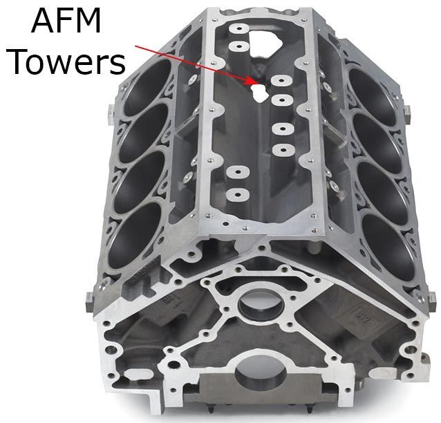

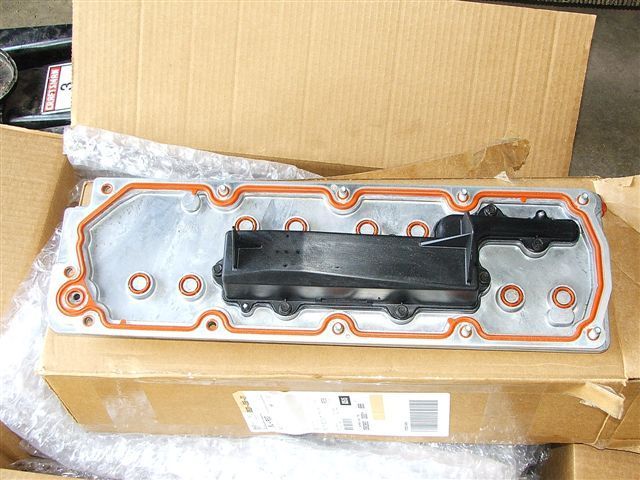

You installed a valley cover that doesn't have the o-rings on the bottom. If your block is machined for DOD then the oil ports must be npt tapped and pipe plugs installed. Can you confirm that the block doesn't have these oil passages present?
Ding, ding, ding.....I think we have a winner!
The LS3 block should have AFM/DOD bosses that need to be plugged.
GM "plugged" these on non-DOD engines by using a valley cover that had o-rings to seal the top of those bosses.
If your Summit valley cover doesn't have those o-rings, like KENS80V said, then you have eight internal oil leaks.
-Chris
Are you freakin' kidding me? No, I don't think the summit valley cover had those.
https://www.summitracing.com/parts/sum-240058
I can slap the original valley cover on and see. Then I will need a way to add oil. I wonder if I can drill a hole in the original valley cover for a plug to add oil. Dammit. I'm taking a long lunch break today. I'll get back to you soon.

Winner, winner, chicken dinner!
Hot Damn. 50psi at idle.
i owe you guys beer.
