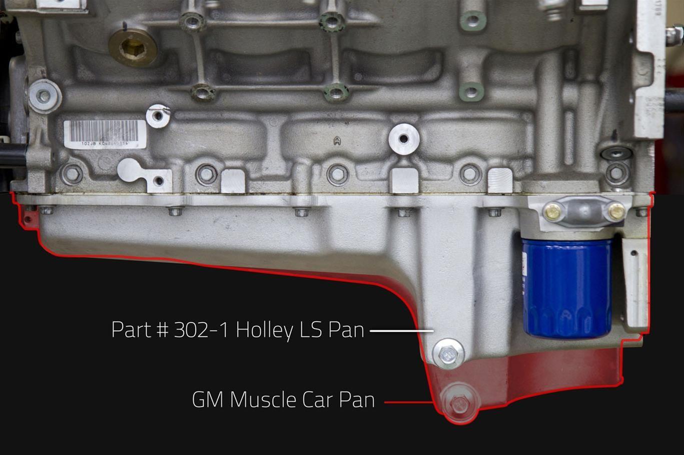

Originally Posted by Bee Jay
Ok, big problem. I got the engine mounted on the engine stand. Look at this oil pan! It’s 8” deep. I assumed I was getting the Holley retro oil pan 302-1. Here is the part# of the pan attached. I don’t this will work. Small problem, I have these LS7 valve covers. There is no way to add oil. Can I modify the engine valley cover with an oil filler cap? Also, the engine came with this cool small balancer with timing marks.
Bee Jay,
There are a few options for your oil pan. You can use an older LS1 Camaro pan (also available new, in kits with the gaskets and pickup tube) or an LS2 Corvette pan. I think that the Holley retrofit pan fits too. I've seen some people use the LS1 Corvette "batwing" pan, but I think that you have to use manifolds with it rather than headers.

Blue Print engines is awesome, especially Kell and Josh. They are shipping a Holley 302-1 oil pan to me today. Only 6" tall, so plenty of ground clearance. I just return the GM Muscle Car pan they shipped me in the same box. They don't recommend the 302-3 because of the extremely long stroke for these LS3 427s, and have experienced interference. Also I'm ordering Summit's Lifter Valley Cover with oil fill cap. Hopefully everything gets here before Saturday so I can drop the engine into the Vette Saturday.

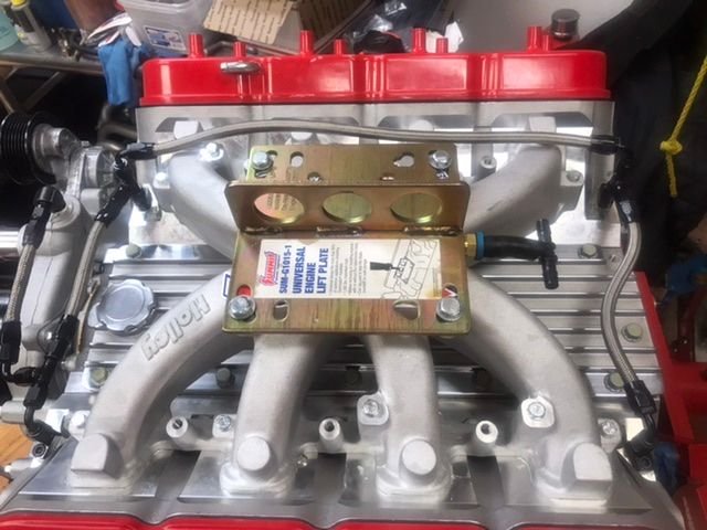

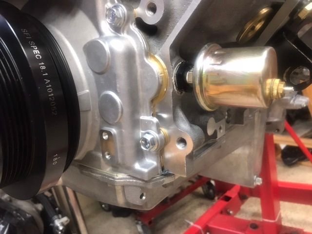

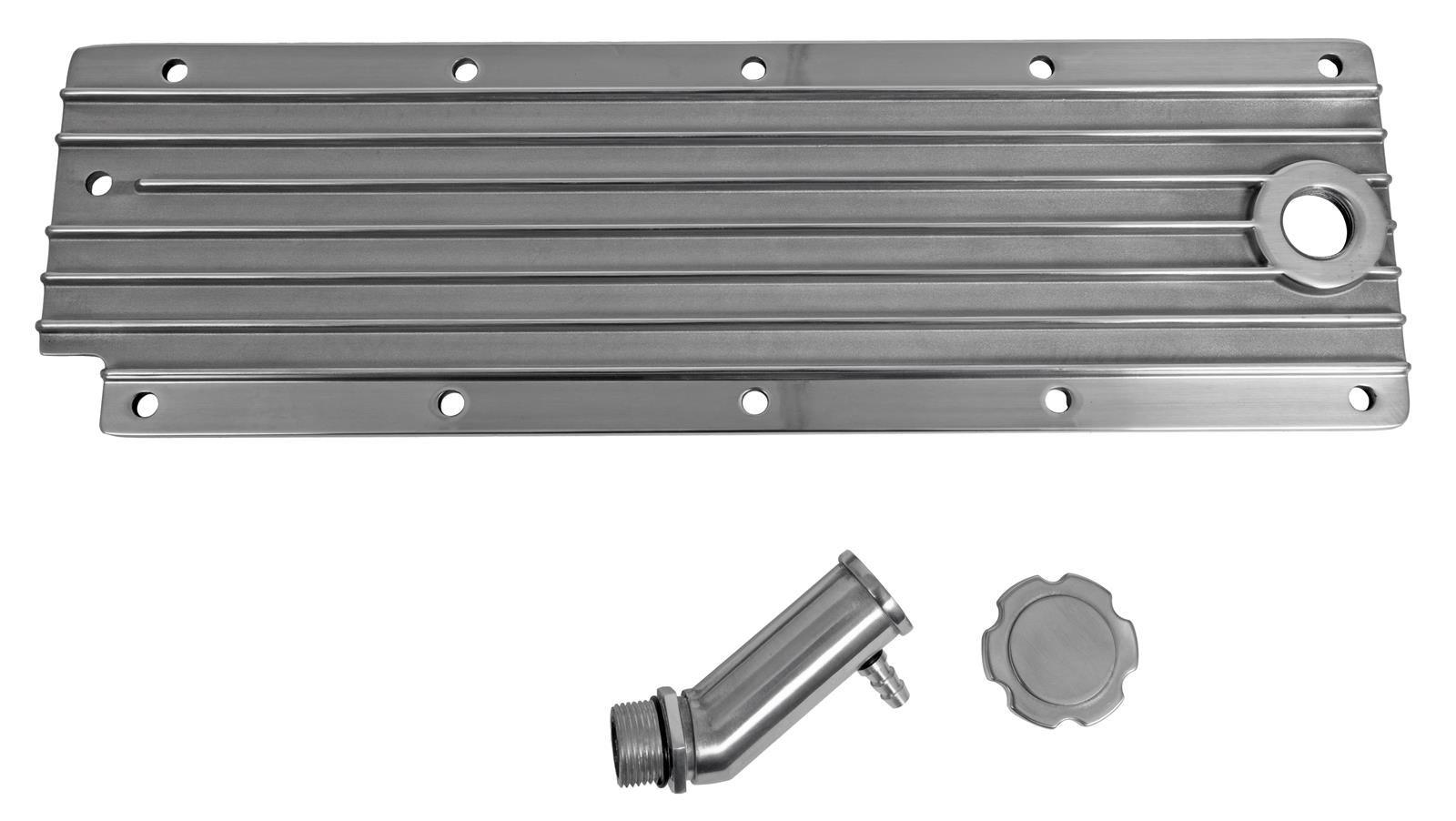

Summit is awesome. The valley cover came overnight. Polished and finned aluminum, and it looks good. The oil filler tube is optional and I decided to put the filler cap on without it. One problem, I lost my oil pressure port, so I moved my oil pressure sensor to the front drivers side of the engine. I’ve read that the pressure will read high here.

I had one thing to do on this engine. Exchange the oil pan, and I screwed that up. I filled the engine with $8 a quart break in lube and cranked with no spark plugs. No oil pressure!!!!! Dang it. After rigging up a pneumatic tester for my oil pressure senders and testing the gauge, I drained and dropped the oil pan. Listen closely, pay attention, the color of the o ring you use on the pick up tube is very important. I reused the brand new red o ring that came in the engine. The new pickup that came with the new oil pan requires a black, or dark brown melling o ring. Watch this helpful video.

Thanks Weatherman. It's a hobby, and this forum is to share and learn. After putting everything back together, I still only say very low oil pressure while cranking, but the needle did move this time. I finished wiring and plumbing last night, so maybe I'll start it this weekend. I better see oil pressure real quick though.

It started and the oil pressure jumped to 60psi immediately. Yea, happy dance, high five. It took a while to get it to idle down at 1000rpm, but it eventually started hitting on all eight and idled. I wanted the water temp to come up before I shut it down, but as the temperature came up, the oil pressure started coming down. 15 psi at 200 degrees idling. Damn it! I’ve been here before, so I shut it down. My 2002 LS1 crew cab never sees less than 30psi, and my LS7 427 Vert sees 100psi when cold and idles at 35-40psi when hot. Maybe the pickup o ring still isn’t in there right. You guys got any ideas. I can’t call blueprint till Monday I bet.

Yea that is pretty low. My Z06 even idling in summer heat at 200 degree temps is at 40 psi. Something does not sound right

Could be that different sensor port. But BluePrint Engines may or may not know depending on who you get to talk to. You could try a known good mechanical gauge at another/better location. I know nothing about LSX motors so couldn't tell you where though.
