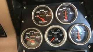

Originally Posted by Bee Jay
Winner, winner, chicken dinner!
Hot Damn. 50psi at idle.
i owe you guys beer.
I know I'm bringing this back from the dead, but I didn't see any new posts about how the new engine is performing and new posts here after you figured out the issue?
Hope it's giving you many miles of reliable adrenaline rushes!
