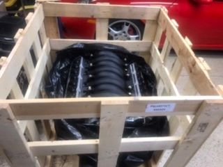

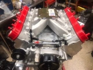

The new 427 LS3 has arrived. Dropped off by this huge 18 wheel Federal Express truck. They really do a good job building crates for these crate engines. I immediately pulled the LS3 intake off and installed the Holley LS3 intake. This intake is 1/2” shorter than the GM LS7 carb intake, so I should gain some hood clearance.
I guess there are no LS7 to LS3 conversion threads, so I’ll just keep adding to this one if that is OK.

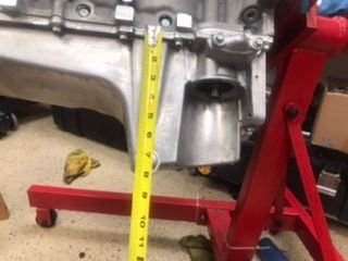

Ok, big problem. I got the engine mounted on the engine stand. Look at this oil pan! It’s 8” deep. I assumed I was getting the Holley retro oil pan 302-1. Here is the part# of the pan attached. I don’t this will work. Small problem, I have these LS7 valve covers. There is no way to add oil. Can I modify the engine valley cover with an oil filler cap? Also, the engine came with this cool small balancer with timing marks.
