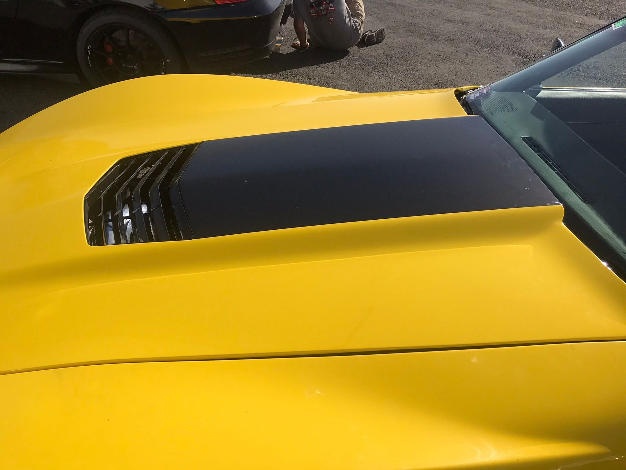

Originally Posted by CA_WxMan
The new hood & vent look really good.
I think that if it were mine, I would paint the center of the hood flat black from the vent back to the back end of the hood, but that's just a personal preference.
Are you going to have the car out for the Santa Maria auto-x on the 10th?
-Chris

Originally Posted by 69427
That would look sharp.
Like this?

Originally Posted by Bee Jay
Like this?
That's exactly what I thinking!
Like this?
Simple and tasteful. Looks sharp.

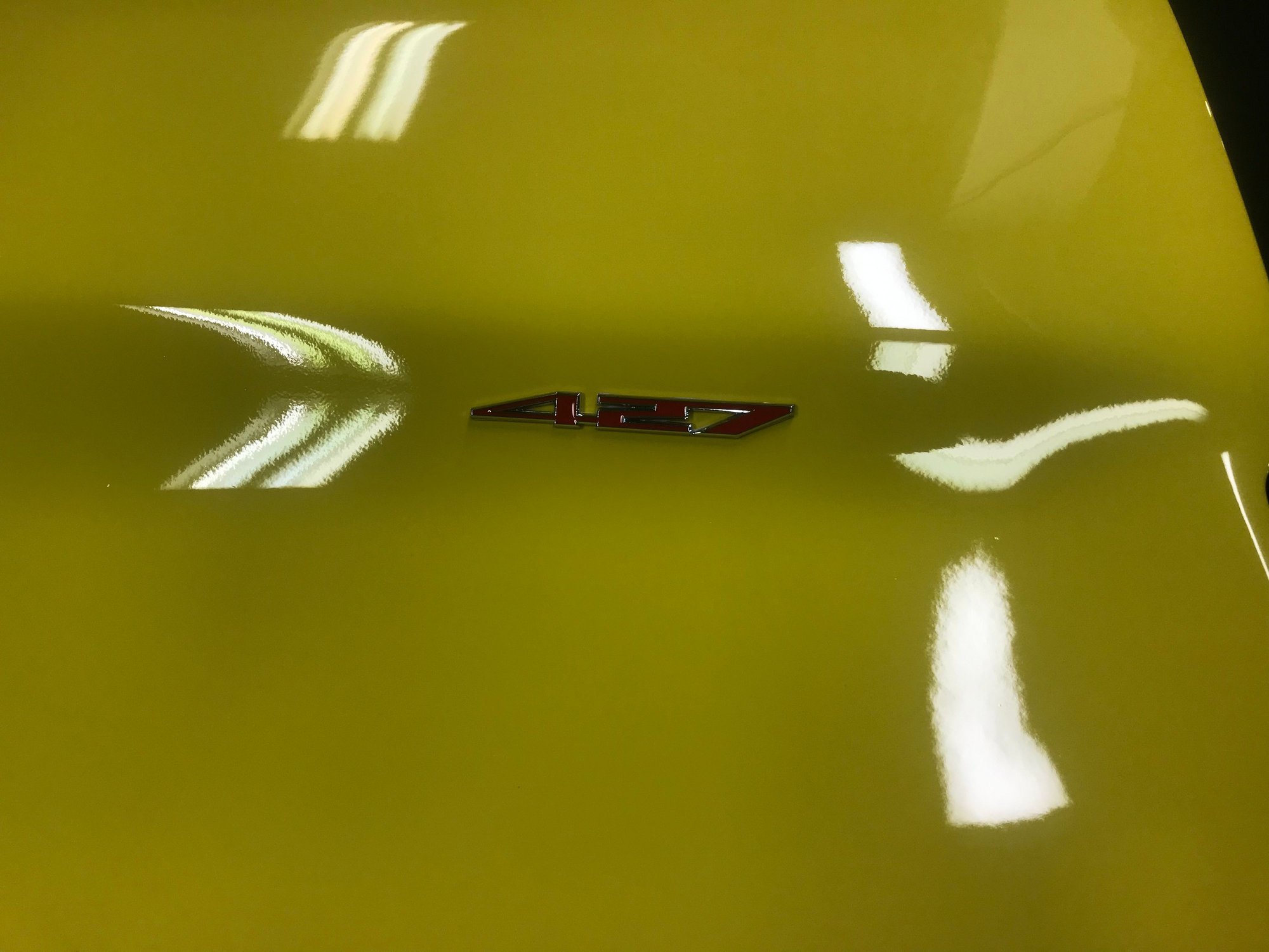

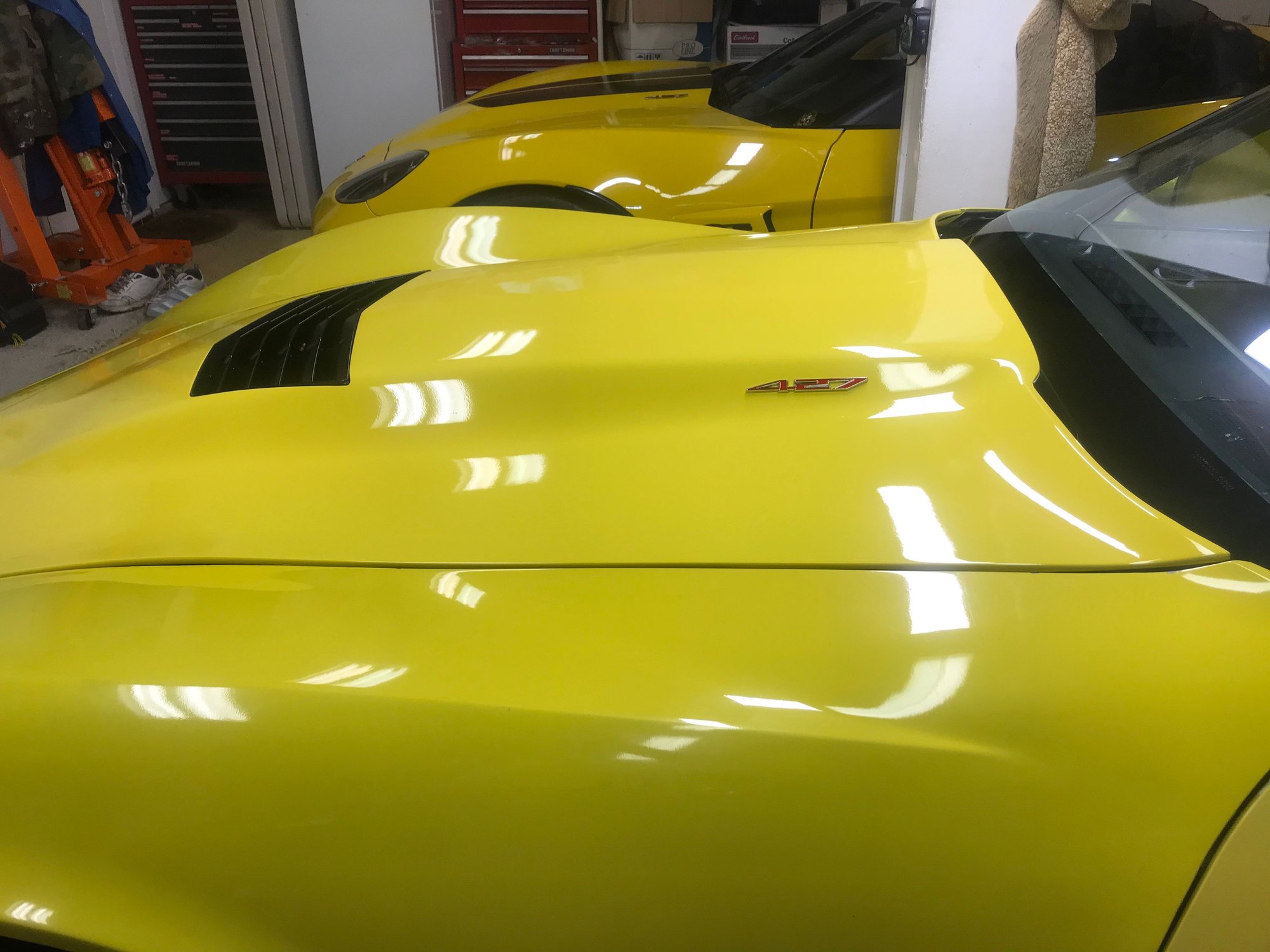

My 427 hood badges arrived! I had a hard time deciding between early C3 placement, front of hood, and late C3 placement, rear of hood. This is what I decided. Maybe those pesky Mustangs will leave me alone now. I could have saved about $10 grand by doing this first.

Very nice and the placement is perfect
That won't stop them, owners of newer cars don't respect big blocks because they always run across stock ones. They will not think it's ls 427
